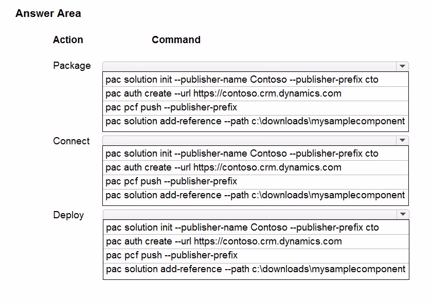

You need to package and deploy a Power Apps code component to an environment.
Which commands should you use? To answer, select the appropriate options in the answer area.

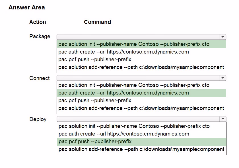

Box 1: pac solution init --publisher-name
Create a new solutions project using the following command. The solution project is used for bundling the code component into a solution zip file that is used for importing into Dataverse. pac solution init --publisher-name developer --publisher-prefix de
Box 2: pac auth create -
Connecting to your environment.
Auth commands are used to authenticate to Dataverse.
Creates the authentication profile for your organization by passing the url parameter. Shows AAD dialog if sign in credentials are not specified.
Example: pac auth create --url https://Myorg.crm.dynamics.com
Box 3: pac pcf push --publisher-prefix
Deploying code components -
After you have successfully created an authentication profile, you can start pushing the code components to the Dataverse instance with all the latest changes.
The push capability speeds up the inner-developer cycle development because it bypasses the code component versioning requirements and does not require that you build your solution (cdsproj) to import the code component.
To use the push capability, do the following:
1. Ensure that you have a valid authentication profile created.
2. Navigate to the directory where the sample component file is located.
3. Run the command.
Incorrect:
Commands for working with Dataverse solution projects include:
Parameter init -
Initializes the solution project. It has the following parameters: publisher-name: Publisher name of the organization. publisher-prefix: Publisher prefix of the organization.

About package, IMO, it is pac solution add-reference. pac solution init -> create a empty project and it does not contain any pcf component yet. pac solution add-reference -> add the pac component to the project, means Package, I think...
Net_IT
Feb 10, 2024
The answer given by exam topics for the first question is correct. Read https://learn.microsoft.com/en-us/power-apps/developer/component-framework/import-custom-controls
uberlord
Feb 28, 2024
wrong, your link says that creates the solution, they still then have to add the reference, no where does the question say that you have to create a solution as well. add ref for the first answer
uberlord
Feb 28, 2024
hai297
Oct 3, 2024
IMO - Add Reference (The action is Package, not Create, so I don't think the Init empty solution is correct) - Auth - Push

Juan0414
Mar 6, 2025
It is not, first step of the "Package a code component" documentation is pac solution init https://learn.microsoft.com/en-us/power-apps/developer/component-framework/import-custom-controls

Answers are correct: pac solution init pac auth create pac pcf push See docs: https://learn.microsoft.com/en-us/power-apps/developer/component-framework/import-custom-controls
itmaxuser
Apr 15, 2025
pac solution init: This command initializes a new solution. You provide the publisher name and publisher prefix. pac solution init --publisher-name Contoso --publisher-prefix cto pac auth create: This command is used to authenticate and create an environment connection. pac auth create --url https://contoso.crm.dynamics.com pac pcf push: This command is used to push the Power Apps component to the environment. pac pcf push --publisher-prefix pac solution add-reference: This command adds a reference to the component in the solution. pac solution add-reference --path c:\downloads\mysamplecomponent
