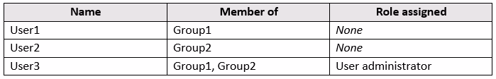

You have an Azure Active Directory (Azure AD) tenant named contoso.onmicrosoft.com that contains the users shown in the following table.

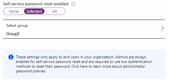

You enable password reset for contoso.onmicrosoft.com as shown in the Password Reset exhibit. (Click the Password Reset tab.)

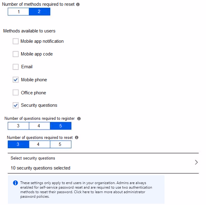

You configure the authentication methods for password reset as shown in the Authentication Methods exhibit. (Click the Authentication Methods tab.)

Answer is not correct. It should be - NO: User2 needs 2 authentication methods. Security questions are not enough to reset password - NO: User1 is not part of the SSPR Group1 - NO: to be able to add security questions to the process. you need Global admin role https://docs.microsoft.com/en-us/azure/active-directory/authentication/tutorial-enable-sspr#prerequisites & https://docs.microsoft.com/en-us/azure/active-directory/roles/permissions-reference#user-administrator-permissions

2 methods available not mandatory so the correct answer i think is Yes-No-No

At the top it says `number of methods required to reset'. The key word there is required. And the mobile phone and security question checkboxes were selected, meaning both methods MUST be used in order to be allowed to reset the password...otherwise nay.

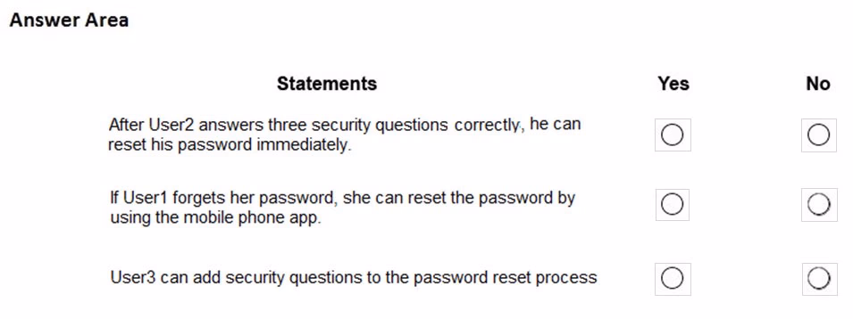

This is a crazy question!! I think the answer should be No, Yes, Yes. Microsoft needs to assess their exam questions. This is not right!! 1st one should be No. According to the Azure Active Directory settings described in the images, two methods are required to reset the password. Therefore, even if User2 answers three security questions correctly, he cannot reset his password immediately because he needs to provide a second method of authentication as well. This ensures an additional layer of security for the password reset process.
LovelyGroovey
Mar 17, 2024
2nd question should be Yes. If User1 forgets her password, she can reset it using the mobile phone app. This is based on the Azure Active Directory settings that allow all users to reset their passwords using the available authentication methods they’ve registered for, which includes the mobile phone app. The settings apply to all end-users, enabling User1 to use the mobile app for password reset.
LovelyGroovey
Mar 17, 2024
3rd question should be Yes. User3, who has the role of “User administrator,” can add security questions to the password reset process. This is because user administrators have the permissions to manage and modify the authentication methods available for password reset within Azure Active Directory, which includes the ability to add security questions.

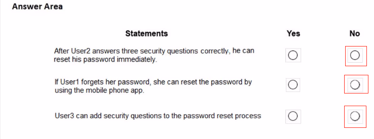

C0rrect Answer: Box 1: No Two methods are required (Mobile phone and Security questions). Box 2: No Self-service password reset is only enabled for Group2, and User1 is not a member of Group2. Box 3: No To be able to add Security questions to the process, you need to be a Global Administrator. User3 is User Administrator, so User3 cannot add security questions to the reset process. User Administrator doesn’t have MFA permissions. Reference: https://docs.microsoft.com/en-us/azure/active-directory/authentication/quickstart-sspr https://docs.microsoft.com/en-us/azure/active-directory/authentication/active-directory-passwords-faq https://docs.microsoft.com/en-us/azure/active-directory/authentication/tutorial-enable-sspr#prerequisites https://docs.microsoft.com/en-us/azure/active-directory/roles/permissions-reference#user-administrator

NO NO NO Tested!

it is No,No No 1st no, because 2 methods requierd 2nd no, because wrong groupmembership 3td no, User 3 is not "An account with Global Administrator privileges.'

No-No-No

1. No - requires 2 methods. 2. No - Group1 can't. 3. No - User Administrator doesnt have MFA permissions. Source : https://docs.microsoft.com/en-us/azure/active-directory/roles/permissions-reference#user-administrator-permissions

N - need mobile phone too N - user2 is not in the group1 N - apparently it needs GA

1. Y Authentication methods When a user is enabled for SSPR, they must register at least one authentication method. We highly recommend that you choose two or more authentication methods so that your users have more flexibility in case they're unable to access one method when they need it. For more information, see What are authentication methods?. The following authentication methods are available for SSPR: Mobile app notification Mobile app code Email Mobile phone Office phone (available only for tenants with paid subscriptions) Security questions 2.NO NO: User1 is not part of the SSPR Group1 3. NO - You need Global Admin role

Still learning azure so excuse the lack of knowledge but the sspr is targetted at group 2, user 1 is not a member, so could they not reset using the mobile app?

NNN is the answer. https://learn.microsoft.com/en-us/azure/active-directory/roles/permissions-reference#user-administrator

N N N is correct!

Tested in LAB : No, No, No

it says "number of questions required to reset = 3". why is everyone stuck on the two METHODS? you need to answer 3 questions. the security question option itself is ONE METHOD. i'd say yes,no,no
StixxNSnares
Mar 2, 2021
It says Number of methods required to reset - 2 (Mobile and Security questions) That being said, just answering the sec questions is not enough.

correct answer i think is Yes-No-No because user2 is only member of Group2

The Number of methods required to reset option determines the minimum number of available authentication methods or gates a user must go through to reset or unlock his password. It can be set to either 1 or 2. Since this option is set to 2, user2 will not be able to reset his password after only one method has been run. User1 is a member of group1. Self-service password reset is enabled only for group2. As a user administrator, user3 cannot add security questions to the reset process. The following Technet articles contain more information about the topic https://learn.microsoft.com/en-us/azure/active-directory/authentication/concept-sspr-howitworks
