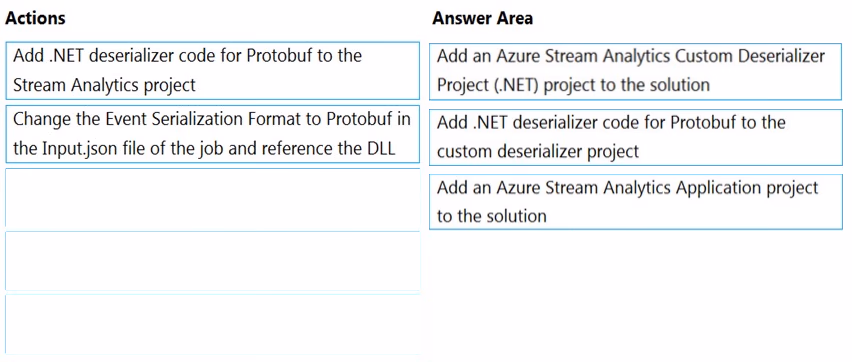

You have an Azure Stream Analytics job that is a Stream Analytics project solution in Microsoft Visual Studio. The job accepts data generated by IoT devices in the JSON format.
You need to modify the job to accept data generated by the IoT devices in the Protobuf format.
Which three actions should you perform from Visual Studio in sequence? To answer, move the appropriate actions from the list of actions to the answer area and arrange them in the correct order.

Step 1: Add an Azure Stream Analytics Custom Deserializer Project (.NET) project to the solution.

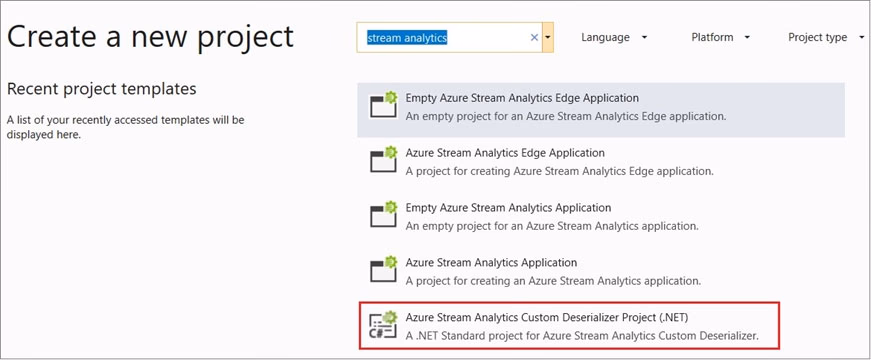

Create a custom deserializer -
1. Open Visual Studio and select File > New > Project. Search for Stream Analytics and select Azure Stream Analytics Custom Deserializer Project (.NET). Give the project a name, like Protobuf Deserializer.

Step 2: Add .NET deserializer code for Protobuf to the custom deserializer project
Azure Stream Analytics has built-in support for three data formats: JSON, CSV, and Avro. With custom .NET deserializers, you can read data from other formats such as Protocol Buffer, Bond and other user defined formats for both cloud and edge jobs.
Step 3: Add an Azure Stream Analytics Application project to the solution

I think for the last step it should be to "change event serialization and reference the dll" since the stream analytics project is assumed to already exist.
Marcello83
Jun 30, 2021
I agree, it seems more logical
