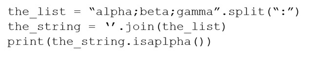

What is the expected behavior of the following code?
The code provided is intended to show the use of Python's string manipulation methods. First, it uses the 'split' method on the string 'alpha;beta;gamma' with ':' as the delimiter, which results in a list containing one element: ['alpha;beta;gamma']. Then, it joins this list back into a single string 'alpha;beta;gamma' using the empty string '' as the join character. Finally, it checks if this string ('alpha;beta;gamma') is composed solely of alphabetic characters using the 'isalpha' method. Since the string contains the ';' character, which is not alphabetic, the 'isalpha' method will return False. Therefore, the expected behavior of the code is to print 'False'.

aferiverOption: C
Apr 13, 2023
C. False typo in alpha() The first line of code creates a list with one element, which is ‘alpha;beta;gamma’. However, the delimiter used in the split method is ‘:’ instead of ‘;’, so the list will only contain one element. The second line of code joins all elements in the list into a single string, which will be ‘alpha;beta;gamma’. The third line of code checks if the string ‘alpha;beta;gamma’ contains only alphabetic characters, which is False because it contains ‘;’.
lukaki
Nov 26, 2021
Answer C; #Example_1 the_list='alpha;beta;gamma'.split(":") print(the_list) the_string=''.join(the_list) print(the_string) print(the_string.isalpha()) # Output: # ['alpha;beta;gamma'] # alpha;beta;gamma # False #Example_2 the_list='alpha:beta:gamma'.split(":") print(the_list) the_string=''.join(the_list) print(the_string) print(the_string.isalpha()) # Output: # ['alpha', 'beta', 'gamma'] # alphabetagamma # True
sadako11
Feb 16, 2022
Another question with a possible typo. Is it supposed to be 'isalpha()' or 'isaplpha()'? Using 'isalpha()' gives a False and using 'isaplpha()' gives an error
carpmatiasOption: C
May 11, 2022
Only if there is a typo in 'isaplpha()' and it means actually 'isalpha()' the it's C
roncr
Nov 5, 2023
there is a typo, is ; instead of : so its B "true"
mazimir
Oct 15, 2021
It outputs: False. Because of .split(":") output of the_list is list with one element ["alpha;beta;gamma"]
Hrishi8888
Oct 29, 2021
The spelling if isalpha() is also wrong in code
Efren
Nov 13, 2021
C- False: the_list='alpha;beta;gamma'.split(":") >>> the_list ['alpha;beta;gamma'] >>> the_string=''.join(the_list) >>> the_string 'alpha;beta;gamma' >>> print(the_string.isalpha()) False
macxszOption: C
May 4, 2022
C. it outputs False
mplopezOption: A
Aug 27, 2023
Hi, check the code twice before give your answers. If you read correctly the code if you execute it you will see that as it's wrote the response is an exception, so the answer is A. Normally, you need to answer as you have in the questionnaire
BonesawOption: B
Feb 1, 2024
I agree with roncr, the ; should be : instead. Also isaplpha() should be isalpha(). Once those are corrected it returns True
Dave304409Option: C
Apr 15, 2025
is correct
