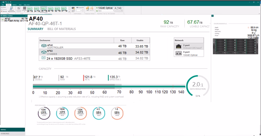

You are designing a new Nimble AF40 for your customer. The array will be added into an existing Nimble HF60 environment connected with SN6000B switches.
You have created the configuration shown in the exhibit and noticed an error.
What should you change in your configuration to ensure it meets the customer requirements?
The necessary change in the configuration is to switch the 10GbE Optical ports to Fibre Channel. The SN6000B switches used in the customer's environment are Fibre Channel SAN switches, which means the storage array needs to have compatible Fibre Channel ports for proper connectivity.

B, SN6000B is FC

Change the 10GbE Optical ports to Fibre Channel, because SN6000B is a Fibre Channel SAN Switch.

B is correct SN6000B switches is a FC San Switch Nimble AF40: Host interface Each array controller has 2 x 10GbE ports built in. Optional ports are 1GbaseT, 10GbaseT, or 10GbE SFP+, or 8/16G Fibre Channel. (https://www.insight.com/en_US/shop/product/Q8H41A/HEWLETT+PACKARD+ENTERPRISE/Q8H41A/HPE-Nimble-Storage-All-Flash-AF40-Base-Array---flash-storage-array/) Nimble HF60: Host Interface Fibre Channel and iSCSI network connectivity (https://buy.hpe.com/emea_europe/en/storage/disk-storage-systems/nimble-storage-arrays/nimble-storage-adaptive-flash-arrays/hpe-nimble-storage-adaptive-flash-arrays/hpe-nimble-storage-hf60-adaptive-dual-controller-10gbase-t-2-port-configure-to-order-base-array/p/Q8H40A) Nimble HF20H: Host InterfaceFibre Channel and iSCSI network connectivity (https://buy.hpe.com/uk/en/storage/disk-storage-systems/nimble-storage-arrays/nimble-storage-adaptive-flash-arrays/hpe-nimble-storage-adaptive-flash-arrays/hpe-nimble-storage-hf20h-adaptive-dual-controller-10gbase-t-2-port-configure-to-order-base-array/p/Q8H71A)

B, the current network interface is Base-T, while the storage will be connected to a san switch
