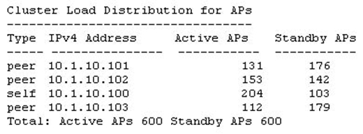

An administrator sets up a cluster of Aruba Mobility Controllers (MCs). What can the administrator determine about the cluster from the command output shown below?
The command output shows the load distribution of APs across different Mobility Controllers (MCs) in the cluster. The total number of Active APs is equal to the total number of Standby APs, indicating that AP load balancing is in effect to distribute the load evenly among the controllers. This balance suggests that AP load balancing is enabled to ensure optimal performance and redundancy.

B is correct (Official Certification Study Guide).

We know because it shows 600 Active and 600 Standby APs.

Not sure how do we know its enabled I thought L2 Connectivity
beardygirl
Apr 15, 2021
I meant to say C. its L2 connected
tdkr147Option: B
Aug 28, 2022
cjoseph
Oct 16, 2022
Answer is B: Active AP rebalance occurs at 50%. It can't be C because L2-connectivity can be seen in a different CLI-output. #show lc-cluster group-membership
