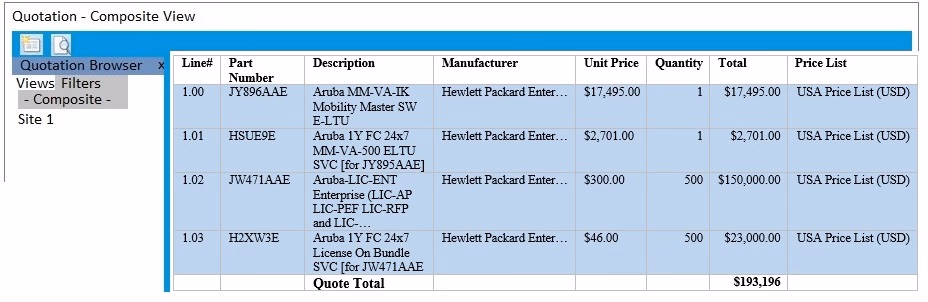

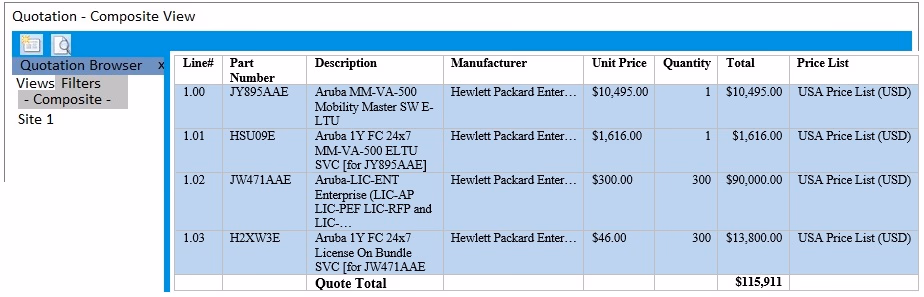

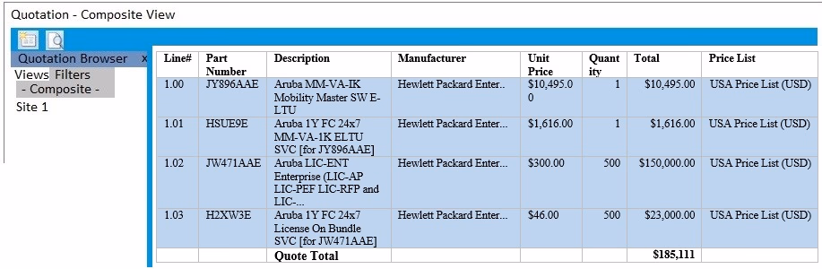

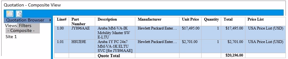

A customer has an existing Aruba network, which currently supports up to 9,000 wireless client devices. The existing network includes these components:
✑ Four 7210 MCs
✑ Five 7030 MCs
✑ 200 AP-303HRs
✑ 300 AP-345s
The customer wants to convert to an ArubaOS 8.x architecture. The architect plans to deploy a virtual MM.
Which exhibit shows the correct BOM for the MM?
A.
Exam HPE6-A49 Question 4
B.
C.
D.
The correct answer is not 'C' as suggested. To support an Aruba network for up to 9,000 wireless client devices with the stated components, it's essential to ensure that the chosen Mobility Master (MM) configuration can handle the scale and requirements. The virtual MM requires appropriate licensing and resources for the APs (500 in total) and client devices. Based on the options provided and the necessary licenses for the transition to ArubaOS 8.x architecture, option 'B' is the most appropriate choice since it includes comprehensive elements like the correct MM-VA-IK mobility master licenses and sufficient licensing for up to 500 APs.

D should be the correct answer
