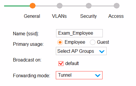

What describes the behavior for this WLAN?
The WLAN configuration shows that the 'Broadcast on' option is set to 'default', which means the SSID will be broadcast by APs in the default group only. In addition, since the 'Forwarding mode' is set to 'Tunnel', it will route traffic through a central controller. Therefore, APs in the default group will broadcast the SSID, and clients can connect to the WLAN only on those APs in the default group.

I'm sure the correct answer is D...

HPE6-a42 Study guide says: Broadcast on—Decide whether to broadcast the SSID on all APs associated with the MC or the MM, or only for select AP groups. If you choose the Select AP Groups option, you are prompted to select one or more AP groups. So, the answer is D..
barsoom1980
Aug 4, 2020
The answer is D
ahmedsoror
Aug 30, 2020
it's D
bobross123Option: D
Oct 18, 2022
answer is D
arubafanboy
Sep 11, 2020
i think no one of the answers is right. becaus no ap group has been choosen. until there is no ap group choosen you can not go forward with the wizzard.
jibin007
Oct 11, 2020
default group mean first SSIDs configured in the controller so the answer is D
sh2003
Dec 13, 2020
D : SSID profile can not be created without any group...If we are not selecting any then default group will be used....and AP in default group will broadcast that SSID.
jrrolong
May 20, 2021
It is missing the info related to Broadcast On option....... we see the only ap group selected is Default but it is not sure what is the Broadcast On selected
MonoPolyOption: D
Mar 25, 2022
AhmedElattarOption: D
Apr 9, 2022
correct answer D
Black777EagleOption: D
Dec 26, 2022
Broadcast only to AP in default group so only connect to the APs in the default group
