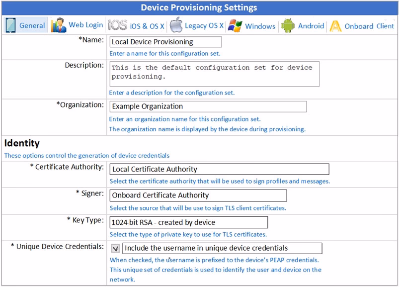

Based on the configuration for the client's certificate private key as shown, which statements accurately describe the settings? (Choose two.)
Correct Answer: AE
The configuration shows that the private key type is set to '1024-bit RSA - created by device.' This means that the private key is generated by the user device itself and is stored there, ensuring that only the device has access to it. Consequently, more bits in the private key will increase security as it makes it more difficult for unauthorized entities to guess or compute the key. Thus, the two correct statements are that more bits in the private key will increase security and that the private key is stored in the user device.
hujinkiOptions: AE
Aug 23, 2022
A and E. Private key is mandatory and must be known only by the device, so B and C are false. More bits in the key make it more difficult to guess.
youuuuuOptions: AC
Sep 8, 2022
I think the private key is on the server. So C is correct, not E.
pabx31Options: AE
Sep 25, 2022
More bits = more security The cert and key are generated by the device, the cert is used by Clearpass to encrypt and the key is used to decrypt. thus kept on the device.
tezkOptions: AE
Oct 24, 2022
