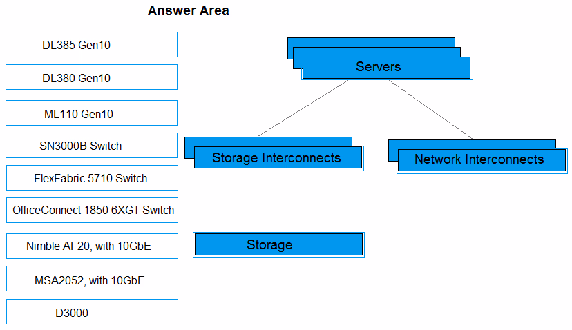

A customer needs a new environment to support an ERP system. The sizing information you received shows the following requirements:
✑ 3 servers with dual AMD processors, 256GB RAM, and 10Gb network connectivity
✑ 10TB of high performance shared storage
✑ Cloud-based performance monitoring and analytics
The customer prefers rack mounted equipment.
Identify the components that will meet the customer requirements, then drag the correct components on the left to their appropriate location in the environment on the right.
Exam HPE0-V14 Question 40

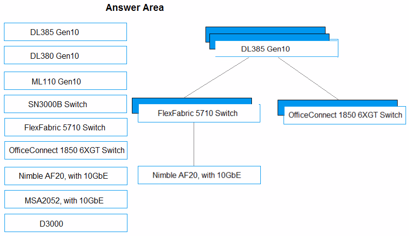

I would choose DL385 servers, FLexFabric switchs for storage and network, and Nimble AF20
LaCruzconFlores
Aug 14, 2020
SN3000B uses FC
sage999
Aug 23, 2020
Ok. But what we must use? (FlexFabric5710(serve+storage) and 1850 6XGT(Server+network) ???)
eshesh
Sep 1, 2020
I agree - But I don't see why we should use the 1850 for the access network?!? So it'm seems kinda weird. Maybe 2 x FlexFabric?
DelHQ
Sep 24, 2020
I'd go with 3 x DL385 Gen10, 3 x 5710 (remember dual path for SAN), 1 x Nimble AF20. Servers and storage are 10Gb ethernet only (no FC stated) so SN3000 is out as FC, 1850 only has six ports so too small for LAN and underpowered for iSCSI SAN.
Psycosis
Sep 16, 2020
DL385 2 x Flexfabric 5710 and AF20 would be my pick The MSA2052 doesn’t come with 10GbE and the DS3000 is FC, so that would leave the nimble AF20 as being the only 10GbE capable storage device https://h20195.www2.hpe.com/v2/getdocument.aspx?docname=a00008277enw The officeconnect switch only just has enough ports, and I would not really class that as a rack mount switch, so that only leaves the 5710
Radiohead316
Sep 26, 2022
I don't see any HBAs, so I'm going DL385, 2x FlexFabric, and Nimble AF20
sontung
Aug 13, 2022
only 3000B support private cloud storage but not support BaseT. Chose DL385, SAN switch and network switch is 5710 and Nimble AF20.
DonChevoDeLaPaca
Oct 29, 2022
