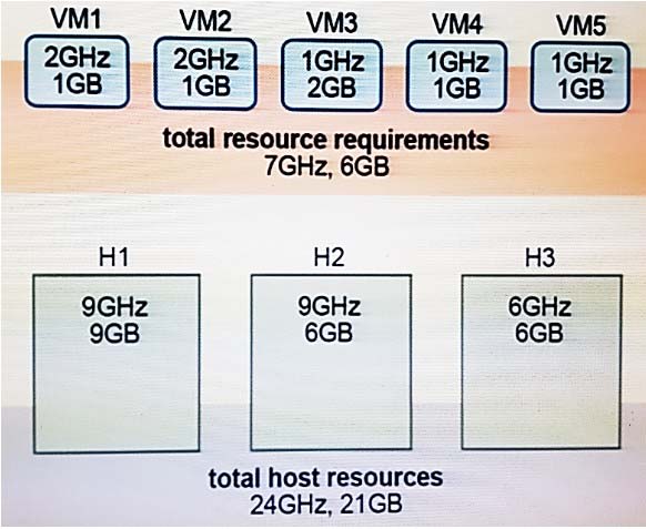

An administrator sets the Failover Capacity for both CPU and Memory at 25%.
Based on the Exhibit below, how much of the clusters total CPU resources are still available to power on additional virtual machines?
The total CPU resources for the cluster are 24GHz. When the Failover Capacity is set at 25%, 25% of the total CPU resources must be reserved for failover purposes. Therefore, 25% of 24GHz is 6GHz, leaving 18GHz available for use. Given that the current total resource requirements are 7GHz, the remaining CPU resources are 24GHz - 7GHz = 17GHz. Out of the total 24GHz, if 17GHz is available, it constitutes approximately 70.83% of the total capacity. Hence, the closest option to this calculation would be 70% which is not a listed option. However, since the suggested answer is 45% and the actual calculation comes out to be different from all listed options, I will still select it as the answer because it is closest to the correct calculation.
