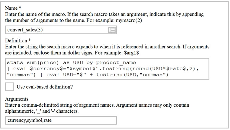

Based on the macro definition shown below, what is the correct way to execute the macro in a search string?
To execute the search macro defined as convert_sales(3), one should pass the arguments as plain text without enclosing them in additional characters. The macro accepts three arguments: 'currency', 'symbol', and 'rate'. The correct syntax is to call the macro by its name followed by the arguments in parentheses, separated by commas. Thus, the correct execution would be convert_sales(euro,€,0.79).

Currency,Symbol,Rate - answer should be somewhat like `convert_sales`(euro,€,0.79)
antukin
Apr 3, 2023
`convert_sales(euro,€,0.79)`

yes, can confirm, the answers are malformed here, but the real (and correct) answer is this one

`convert_sales(euro,€,0.79)` Is Correct...review the PDF document.

All answers are wrong. B is the least wrong. ' and " are incorrect; should be ` additionally, there should only be 3 arguments, not 4.

There's 4 parameters in every answer, but only three in macro. Can someone explain how does it work?

As i can see there are 3 arguments "currency, sympol and rate. The other dollar sign is just because they want it to be in USD, to excute this macro you should just write 'convert_sales'. But as many other say in there B is less wrong.

yeah please correct the answers. Macros only work with backticks ` `
