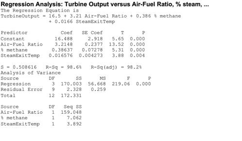

Which statement(s) are most correct for the Regression Analysis shown here?
The regression analysis provided indicates that the model has an R-Sq value of 98.6% and an R-Sq (adjusted) value of 98.2%, signifying that the model explains over 98% of the variation in Turbine Output. The term 'Simple Linear Regression' in option C does not apply, as this is a Multiple Linear Regression, but the percentage of explained variation stated in the option is correct.
InvisibleBeingOption: B
Jun 9, 2023
B is the correct answer. The reason why C is incorrect = Simple linear regression is used to model the relationship between two continuous variables. In this example we have more than two (total 3) independent variables
