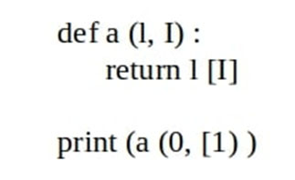

What is the expected behavior of the following snippet?
It will:

A. Here is another example to give you a gist of what it should have been if it was coded correctly def a (I, L): return l [L] my = [1, 2, 3, 4] print (a(my, 3)) #Answer 4 L now picks the index number 3 in my which is I

A. cause a runtime exception

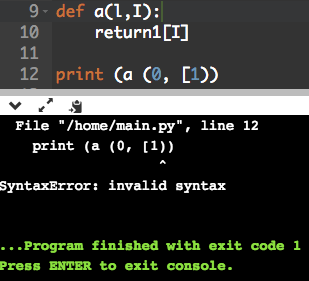

Syntax error

the error is due to print statement while sending the list the have use [)

A. Caused run time exception even if the syntax is correct it would throw error as positional arguments is not in correct position if calling function is a([1],0) instead of a(0,[1]) then it gives output as 1

#question 24 def a (l, I): return l [I] print (a(0, [1)) #SyntaxError: closing parenthesis ')' does not match opening parenthesis '[' Tested: A (cause a runtime exception)

Correct code def a(l,I): return l[I] print (a([1],0))
