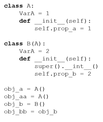

Assuming that the following piece of code has been executed successfully, which of the expressions evaluate to True? (Choose two.)
Correct Answer: AB
The expression 'isinstance(obj_b, A)' evaluates to True because class B inherits from class A, making an instance of B also an instance of A. The expression 'A.VarA == 1' is True because within the definition of class A, 'VarA' is explicitly set to 1. Thus, these two expressions are correct. The other options are incorrect because 'obj_a is obj_aa' evaluates to False since 'is' checks for identity, and 'obj_a' and 'obj_aa' are two separate instances. 'B.VarA == 1' is False because in class B, 'VarA' is set to 2.

Its: True True False False
Misco33
Nov 6, 2021
That's correct, try this code: class A: VarA = 1 def __init__(self) -> None: self.prop_a=1 class B(A): VarA = 2 def __init__(self) -> None: self.prop_b=2 obj_a = A() obj_aa = A() obj_b=B() obj_bb=B() print(isinstance(obj_b,A)) print(A.VarA==1) print(obj_a is obj_aa) print(B.VarA == 1)

A. isinstance (obj_b,A) B. A.VarA == 1

>>> isinstance(obj_b, A) True >>> A.VarA == 1 True >>> obj_a is obj_aa False >>> B.VarA == 1 False
