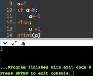

What is the expected output of the following snippet?

locloc91Option: D
Aug 14, 2019
Since the else is indented incorrectly, the code will be erroneous!
naveenbv80Option: A
Dec 2, 2022
If the indentation is correct then answer is 3 a=2 if a>0: a+=1 else: a-=1 print(a) If the indentation is not correct, the answer is "the code will be erroneous" a=2 if a>0: a+=1 else: a-=1 print(a)
TherizzzlaOption: D
Jan 8, 2020
In the answer given, the indentation error is fixed, therefore the answer would be 3. But because the else is not indented properly in the question, when you run the code it will give an error. Tried this in python itself and a compiler.
PygineerOption: D
Dec 5, 2019
error, indentation error
gherulloaOption: D
Apr 27, 2022
Option D: if ran as in the question, it throws "invalid syntax" error
palagusOption: D
May 24, 2022
The code is erroneous.
PremJaguarOption: D
Jul 18, 2022
The code should be erroniouse
SophieSuOption: A
Dec 3, 2019
3 is the correct answer.
macxszOption: D
May 3, 2022
indentation is incorrect: D. the code is erroneous
666_mOption: D
May 16, 2022
follow the indentation of the question, the answer is D
Jiansy90Option: D
Jun 22, 2022
Answer is D, There is indentation mistake.
N9Option: D
Sep 3, 2022
code is not indented properly. Output : line number <number> invalid syntax else: ^^^^
ivanbicalhoOption: D
Feb 19, 2023
The indentation is not correct
varshu_0708Option: D
May 9, 2023
"else" indentation is not correct. so the answer is D. if the indentation is correct, the ans will be 3
Ello2023Option: D
May 10, 2023
Just tested this code and the "else:" has the wrong indentation and therefore, it never worked.
Ello2023Option: D
May 16, 2023
There are 2 mistakes Firstly, there is missed quotes Secondly, the else is not indented correctly
mplopezOption: D
Jul 23, 2023
The "else" part is not correctly indented
