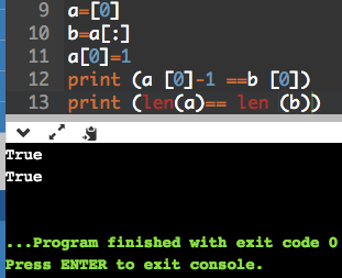

After executing the snippet: a = a[0] = 1 b = b[0] = 0

>>> len(a)==len(b) True >>> a [0]-1 ==b[0] True >>> a [0]== b [0] False >>> b [0] - 1 ==a [0] False

a=[0] b=a[:] a[0]=1 print(len(a) == len(b)) --> True print(a[0] - 1 == b[0]) --> True print(a[0] == b[0]) --> False print(b[0] - 1 == a[0]) --> False My answer is C and D

Correct Answer should be C and D as the question says which equations are False a = [0] b = a[:] a[0] = 1 a[0] # is 1 b[0] # is 0 so: print(len(a) == len(b)) # => True print(a[0] - 1 == b[0]) # => True print(a[0] == b[0]) # => False print(b[0] - 1 == a[0]) # => False
