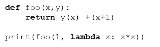

What is the expected output of the following code?
A

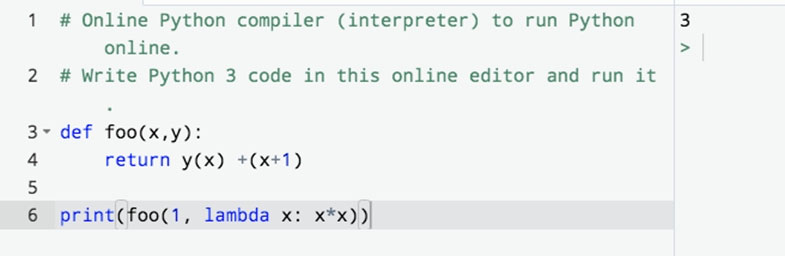

in the invocation of foo() in the example there's clearly an L and not a 1... Assuming it's supposed to be a 1: A is correct, if it's an L: D is correct.
macxszOption: A
May 4, 2022
answer: A. 3
swatiphadtare
Apr 4, 2023
What kind of statement is y(x)? how does that work? can someone please explain?
Simdjen
Sep 27, 2023
y becomes 'lambda x: x*x' as stated in the print function. With x == 1 we will get lambda x: 1*1(1) + (1+1) = 3
swatiphadtareOption: D
May 6, 2023
I get exception for return y(X) statement
AxiansPT
Jul 13, 2023
y(x) ????
