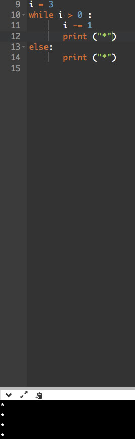

How many stars (*) does the following snippet print?

cgranadilloOption: D
Jan 26, 2021
I just run this script using this console: https://www.programiz.com/python-programming/online-compiler/ Result was 4 starts Answer is D
aroheraOption: D
Mar 23, 2022
It will be D as first the value is 3 so a star will be printed, then one for 2 and 1 each, then the value will be 0 so it will go in the else statement and print one start, so total 4 stars

D. 4 stars. Please before answering try running the code first. Maybe u are forgetting that after the while loop finishes the else: print("*") will execute.

macxszOption: D
May 3, 2022
answer: D. four
