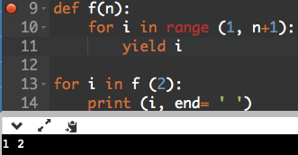

ruydrigoOption: D
Dec 3, 2021
I run it but I don't understand why yield return 1,2
techdawgs
Dec 4, 2021
With f(2), n = 2, so the range will be range(1, {2+1}) or range(1,3). The iterations of i would then be 1 and then 2 with yield sending each iteration back to "for i in f(2)". Hope this explains it.
