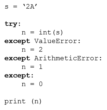

What is the expected behavior of the following code?
D
Jos015Option: D
Nov 8, 2023
ValueError s = '2A' try: n = int(s) except ValueError: n=2 except ArithmeticError: n=1 except: n=0 print (n)
macxszOption: D
May 4, 2022

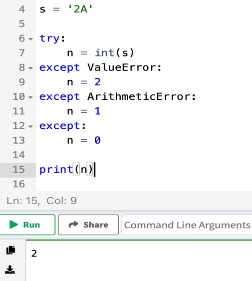

D. it outputs 2
RizosOption: D
Mar 14, 2023
Can anyone explain what is happening here? why is the answer 2?
noobplayer
Apr 1, 2023
because it causes ValueError. you cannot cast the input to int because there is a character within
