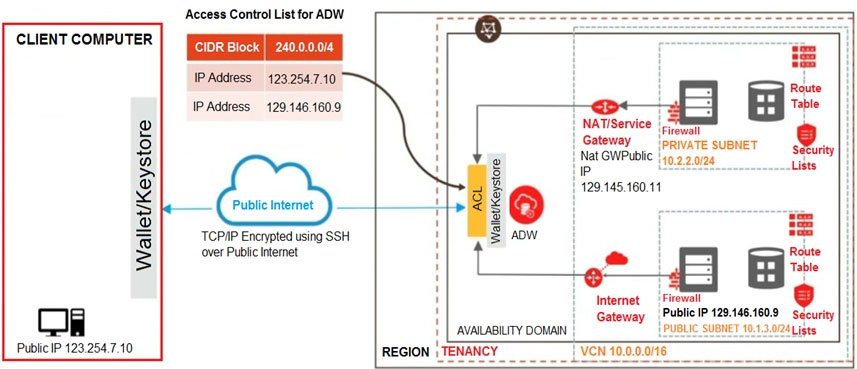

You designed and deployed your Autonomous Data Warehouse (ADW) so that it is accessible from your on-premise data center and servers running on both private and public networks in Oracle Cloud Infrastructure (OCI).
As you are testing the connectivity to your ADW database from the different access paths, you notice that the server running on the private network is unable to connect to ADW.
Which two steps do you need to take to enable connectivity from the server on the private network to ADW? (Choose two.)
Correct Answer: BC
To enable connectivity from the server on the private network to the Autonomous Data Warehouse (ADW), you need to add an entry in the route table associated with the private subnet for routing the traffic through the NAT Gateway, and you need to update the access control list (ACL) of ADW to include the IP address of the NAT Gateway. Adding an entry in the route table with a destination of 0.0.0.0/0 and the target type of NAT Gateway allows the private subnet to route traffic to external networks using the NAT Gateway. Including the NAT Gateway's public IP address in the ACL ensures that ADW can accept connections from the private network routed through the NAT Gateway. Option A, which suggests modifying the security list of ADW, is not correct because ADW does not have security lists; it uses ACLs to control access.

B and C are correct, there seems to be an IP typo though.

Not true. the ADW has no idea what the private IP address means to it. It needs the public IP of the NAT gateway. It should be B and C

Correct is B&C . the NAT gateway ip address is required to be in the ACL. Ensure that the Access Control List for the Autonomous Database (ADB) has the necessary entries for CIDR Block ranges and IP addresses. When connecting to ADB from a server running on a private subnet (on the same OCI tenancy as the ADB), ensure that you have a service gateway or NAT gateway attached to the VCN. The route table for the subnet needs to have the appropriate routing rules for the service gateway or NAT gateway. The security lists for the subnet will need to have the right egress rules.

Answer C and the NAT Gateway Public IP address doesn't match. Suppose it's a typo, otherwise C cannot be the answer
plafaurie
Aug 30, 2021
C is wrong, because the IP address, in the graph is 129.145.160.11 and in the answer it is 129.146.160.11, it has the second different octet

I did the exam and I passed, they asked me this question, the IPs are the same between the diagram and the answer, therefore the answer C is correct.

Its B and E. So - we largely agree that B is correct. So its down to whether the access Contrl List needs the CLIENT or the PRIVATE SUBNET adding. - C is wrong as the question isnt about accessing from the CLIENT computer, its about accessing from the PRIVATE SUBNET.

Scratch that - helps if I can read the IP addresses correctly. its B and C!

Correct Answers are B and C Can someone update the answers? For Option A: Security List, since sec lists are at subnet level ADW doesn’t have a security list. If it did have a list it and would need source, dest, and type of traffic. Not enough info for option A and doesn’t apply to ADW. For Option D: Resources that need to connect to the Internet must be in a PUBLIC subnet and have a PUBLIC IP address. A private subnet would need to go through a NAT. Therefore, Option D is not valid. For Option E: is ruled out due to the given CIDR block being private when a public one is needed. That’s why it goes through the NAT. ADW Access Control List (ACL): IP address in the ACL is the PUBLIC facing address on the public internet that you want to grant access. CIDR Block, is the public CIDR block of the clients that are visible on the public internet that you want to grant access.

B,C... ignoring the typo in the answer C

A is wrong because the ADW has no Security List. B is correct as the private subnet needs a route entry to exit on internet through the NAT gateway C is "correct" because the ADW's ACL needs an entry for 129.145.160.11 (either the diagram or the C answer has got a typo, the second octect should match). D is wrong, a private subnet has no use for an Internet Gateway E is wrong, as the 10.2.2.0/24 CIDR block is hidden by the NAT Gateway and not visible by the ADW
