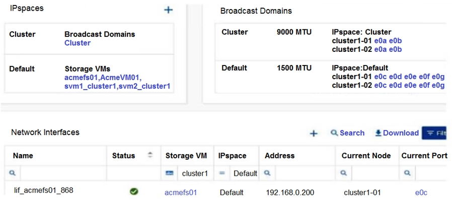

Click the Exhibit button.
You have an ONTAP 9.8 cluster. After network maintenance, the LIF that is shown in the exhibit is not always on a correct port and is unreachable by users until the LIFs are moved to port e0c or e0d on either storage node.
In this scenario, which action should you take to ensure that the LIF only fails over to the correct ports?
In this scenario, the issue is that the LIF is not always on the correct port and becomes unreachable by users unless it is moved to specific ports (e0c or e0d on either storage node). To address this issue, you need to split the broadcast domain to ensure that the LIF only fails over to the correct ports. By creating a new broadcast domain that includes only the correct ports (e0c and e0d), you can prevent the LIF from failing over to other, incorrect ports. Therefore, splitting the broadcast domain is the appropriate action to take.

should be B, include only e0c and e0d in the new broadcast domain

B. There are obviously some ports in the broadcast domain that are unreachable.

B is correct split off e0c /d https://docs.netapp.com/us-en/ontap/networking/split_broadcast_domains.html

split the BD

B. Split the broadcast domain

B, Split the broadcast domain

That broadcast domain is large

Correct B. It looks like "broadcast-domain split -broadcast-domain Default -new-broadcast-domain Default2 -ports cluster1-01:e0c, cluster1-01:e0d, cluster1-02:e0c, cluster1-02:e0d"
