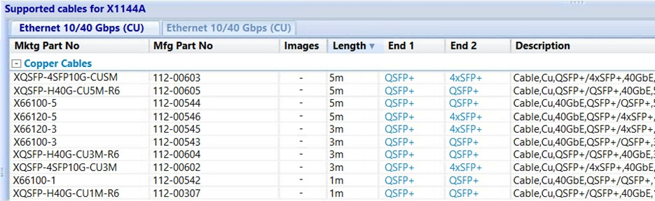

Click the Exhibit button.
A customer has two Cisco 40GbE data switches. They want to connect the switches to an AFF A400 HA pair. The switches and the AFF A400 are approximately seven meters apart.
Referring to the exhibit, which two supported actions would allow you to accomplish this task? (Choose two.)
Correct Answer: AD
To connect the customer’s Cisco 40GbE data switches to the AFF A400 HA pair, given the seven-meter distance, you need to either relocate the switches or the AFF A400 so that the distance is within the supported range for copper cables, which is less than five meters. Alternatively, you can change the requirement for optical cables, as optical cables typically support longer distances than copper cables, addressing the seven-meter requirement.
e3lOptions: AC
May 20, 2021
A and C, the hwu isn't showing 10 meters cables
cleeregisterOptions: AD
Jul 19, 2021
A and D, change to Ethernet 40 Gbps (Op), supported up to 30m.
mppcood5Options: AD
Jul 6, 2023
I think A and C "from Ethernet(Cu) to Ethernet(Op)" X66200-30 Cable,Opt,OM4,MPO/MPO,Type B,30m Ethernet 40Gbps (Op)
skyleiOptions: AC
Nov 3, 2023
AC X1144A is a ethernet adapters
