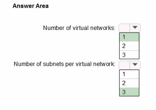

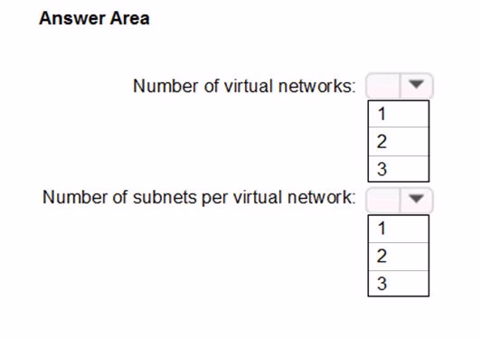

You need to recommend a solution for App1. The solution must meet the technical requirements.
What should you include in the recommendation? To answer, select the appropriate options in the answer area.
Exam AZ-103 Question 184

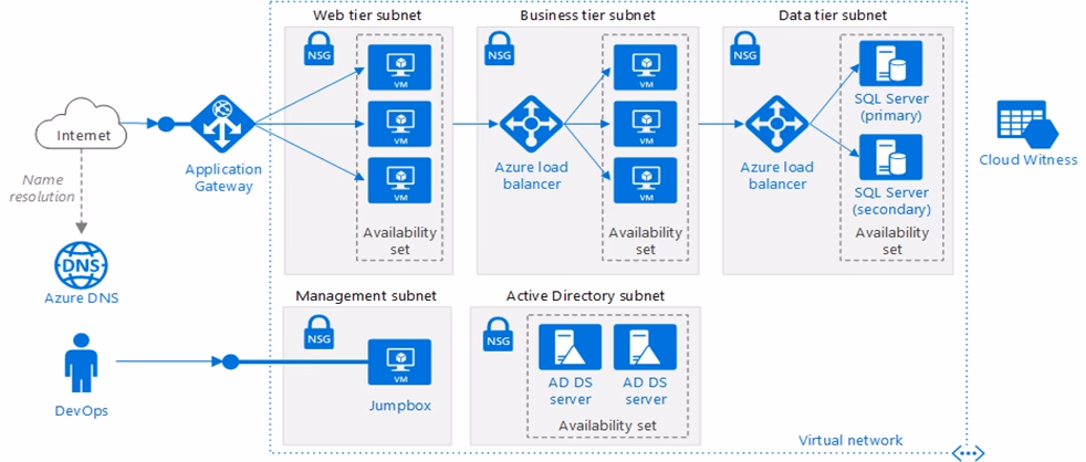

This reference architecture shows how to deploy VMs and a virtual network configured for an N-tier application, using SQL Server on Windows for the data tier.
Scenario: You have a public-facing application named App1. App1 is comprised of the following three tiers:
✑ A SQL database
✑ A web front end
✑ A processing middle tier
Each tier is comprised of five virtual machines. Users access the web front end by using HTTPS only.
Technical requirements include:
✑ Move all the virtual machines for App1 to Azure.
✑ Minimize the number of open ports between the App1 tiers.
https://docs.microsoft.com/en-us/azure/architecture/reference-architectures/n-tier/n-tier-sql-server

CarlosBarrero
Jun 16, 2020
number virtualnetworks is 1 and subnets 3 ?
macco455
Jun 19, 2020
Answer is correct.
Jul 7, 2020
Yes, APP1 is 3 tier app.

Rajat0702
Aug 2, 2020
Should be 1 and 2 ,microsoft sql server is managed service and does not required a new subnet.
sarah_t
Aug 8, 2020
It says "Each tier is comprised of five virtual machines." this includes the DB tier.
_syamantak
Aug 7, 2020
Wrong answers. No of VNet : 1 , No of Subnet : 2 First of all, SQL server is a managed service and we can not put it to specific subnet. Also, if at all it needed a subnet (assuming sqlserver database into a vm), we still could put in the same subnet of the Middle Tier. Middle tier is not accessible to the users.
TzzZ
Aug 23, 2020
1d10t 3 tiers plus gateway subnet and jumpbox subnet, should be 5, but 3 is ok in the answer
xiaolin
Aug 23, 2020
SQL Server - 5 vms, it's iaas not paas
I
Feb 26, 2021
Answers are correct! 3 tiers so 3 subnets in 1 vitual network.
_cube_
Sep 23, 2021
Who stops you to put all the tiers in the same subnet though? It just says the frontend ties is accessed via HTTPS so just create an NSG for them and put everything in the same subnet.
