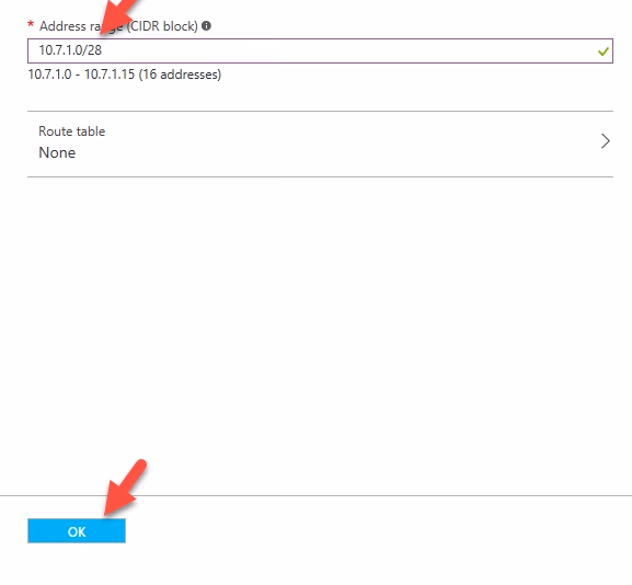

We need to create a Gateway subnet
Step 1:
Go to More Services > Virtual Networks
Step 2:
Then click on the VNET1017, and click on subnets. Then click on gateway subnet.
Step 3:
In the next window define the subnet for the gateway and click OK
Exam AZ-303 Question 220
It is recommended to use /28 or /27 for gateway subnet.
As we want to maximize the IP address space we should use /27.

I believe /28 is correct. https://docs.microsoft.com/en-us/azure/vpn-gateway/tutorial-site-to-site-portal /28 leaves more IP address spaces for VMs as required here.

/28 is enough when you have one gateway. Here you have two (VPN and ExpressRoute), thus must be /27 per https://docs.microsoft.com/en-us/azure/expressroute/expressroute-howto-coexist-resource-manager#add

Agree /27, as posted in the article: https://docs.microsoft.com/en-us/azure/expressroute/expressroute-howto-coexist-resource-manager#new "The Gateway Subnet must be /27 or a shorter prefix (such as /26 or /25)."

Not if you have both VPN and ExpressRoute. "If you have a virtual network that has only one virtual network gateway (let's say, Site-to-Site VPN gateway) and you want to add another gateway of a different type (let's say, ExpressRoute gateway), check the gateway subnet size. If the gateway subnet is /27 or larger, you can skip the steps below and follow the steps in the previous section to add either a Site-to-Site VPN gateway or an ExpressRoute gateway. If the gateway subnet is /28 or /29, you have to first delete the virtual network gateway and increase the gateway subnet size."

Mentioned link states, that /29 is a minimum for VPN-only and that it's not enough for VPN+ExpressRoute. /29 is too small /28 - there is not enough info in docs (except that it was previous minimum for a VPN) /27 is a recommended minimum

https://docs.microsoft.com/en-us/azure/vpn-gateway/tutorial-site-to-site-portal When you create the gateway subnet, you specify the number of IP addresses that the subnet contains. The number of IP addresses needed depends on the VPN gateway configuration that you want to create. Some configurations require more IP addresses than others. We recommend that you create a gateway subnet that uses a /27 or /28. /27/ or /28 is right.

it should be /27. question said for both expressroute and VPN. which means 2 gateways. \28 only allows one in gateway subnet
