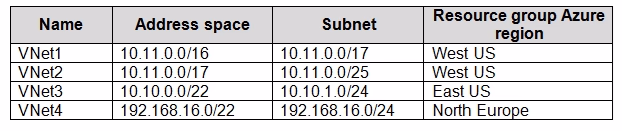

You have the Azure virtual networks shown in the following table.
Exam AZ-103 Question 104
To which virtual networks can you establish a peering connection from VNet1?
You cannot establish a peering connection between virtual networks that have overlapping address spaces. VNet1 (10.11.0.0/16) and VNet2 (10.11.0.0/17) have overlapping address spaces, so they cannot be peered. VNet3 (10.10.0.0/22) and VNet4 (192.168.16.0/22) do not have overlapping address spaces with VNet1 and can be peered with VNet1. Therefore, the correct answer is that you can establish a peering connection from VNet1 to VNet3 and VNet4 only.

C. VNet3 and VNet4 only

Vnet1 and Vnet2 IPs are overlapping.

Agreed - has to be C as VNet1 and VNet2 overlap with both the address space and subnets. See here: https://www.microsoftpressstore.com/articles/article.aspx?p=2873369 "The address space is the most critical configuration for a VNet in Azure. This is the IP range for the entire network that will be divided into subnets. The address space can almost be any IP range that you wish (public or private). You can add multiple address spaces to a VNet. To ensure this VNet can be connected to other networks, the address space should never overlap with any other networks in your environment. If a VNet has an address space that overlaps with another Azure VNet or on-premises network, the networks cannot be connected, as the routing of traffic will not work properly."

Agree with ExamPrep. https://docs.microsoft.com/en-us/azure/virtual-network/virtual-network-manage-peering#create-a-peering Virtual network: Select the virtual network you want to peer with. You can select a virtual network created through either Azure deployment model. If you want to select a virtual network in a different region, you must select a virtual network in a supported region. You must have read access to the virtual network for it to be visible in the list. If a virtual network is listed, but grayed out, it may be because the address space for the virtual network overlaps with the address space for this virtual network. If virtual network address spaces overlap, they cannot be peered. If you checked the Resource ID checkbox, this setting isn't available. In the question, VNet1 address space (10.11.0.0 - 10.11.255.255) and VNet2 address space (10.11.0.0 - 10.11.127.255) are overlapping with each other. So we can't setup peering between these 2 networks. So, the answer is C. VNet3 and VNet4 only.

the correct answer is C - only vnet3 and vnet4. I was quite certain about it as the Addresses are overlapping but i checked on multiple sites and everywhere the answer was all the three vnets so i tried it myself to just clear it. i Could not do the peering so for sure the answer is vnet3 and vnet 4 only. Cheers.

It cannot connect to vnet2! Region has nothing to do but the IPs are overlapping so in the portal u wont even see vnet2 while creating ur vnet peering.

i did practically. vnet3 an vnet4 is correct. vnet1 and vnet2 are overlaping

Answer: C Just tested. You can't peer Vnets if their address space overlaps.

Answer: C https://docs.microsoft.com/en-us/azure/virtual-network/virtual-networks-faq#:~:text=overlapping%20address%20ranges%3F-,No.,overlap%20to%20enable%20VNet%20Peering. Can I peer two VNets with matching or overlapping address ranges? No. Address spaces must not overlap to enable VNet Peering.

I created vnet with exact same config and when tried to peer vnet1 and vnet2 then i could see azure says it cannot be peered . Hence answer is C

tested this- only Vnet3 and vnet4. interestingly it allows you to create the vnet2 with subnet with a warning.
