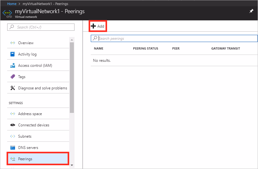

Step 1. In the Search box at the top of the Azure portal, begin typing VNET01-USEA2. When VNET01-USEA2 appears in the search results, select it.
Step 2. Select Peerings, under SETTINGS, and then select + Add, as shown in the following picture:

go to virtual networks, select one of the two vnet and in that pane you can choose peerings. Select add and fill in the next items: - peering name and leave the rest default (since it will allow all traffic and route traffic) - Remote virtual network, fill in a name for the peering (it is used for the config of the other peering) - select remote virtual network and leave the rest default (since it will allow all traffic and route traffic) That's it. Tested it with two vm's (each in different vnet) and it works.
