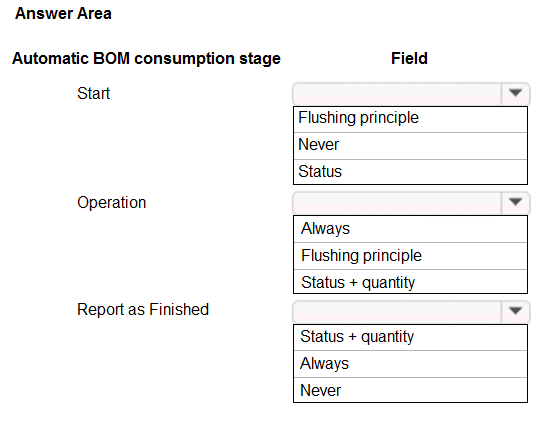

MB-320 Exam - Question 141
You need to resolve the production manager issue.
How should you configure manufacturing execution? To answer, select the appropriate option in the answer area.
https://docs.microsoft.com/en-us/dynamicsax-2012/appuser-itpro/about-production-parameters-in-manufacturing-execution

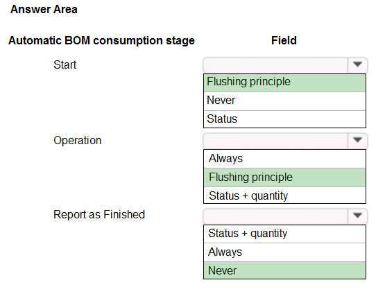

Pir
May 31, 2021
Correct. If the Flushing principle field is selected on the Start tab in Manufacturing execution, you must also select that same principle on either the Operations tab or the Report as finished tab. This is to make sure that materials are deducted from inventory on the BOMs that use Finish as a flushing principle on the production order. It is important that either the Operations tab or the Report as finished tab – contains the Flushing principle selection. This is to prevent materials from being deducted two times from inventory.
Alexpet
Oct 31, 2021
I believe this is the only option that supports the many use cases under the reporting section.
ZVV
Feb 19, 2021
I don't see the requirement for Flushing principle here :-\
Pir
May 31, 2021
