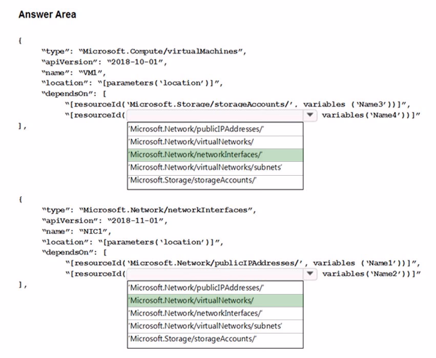

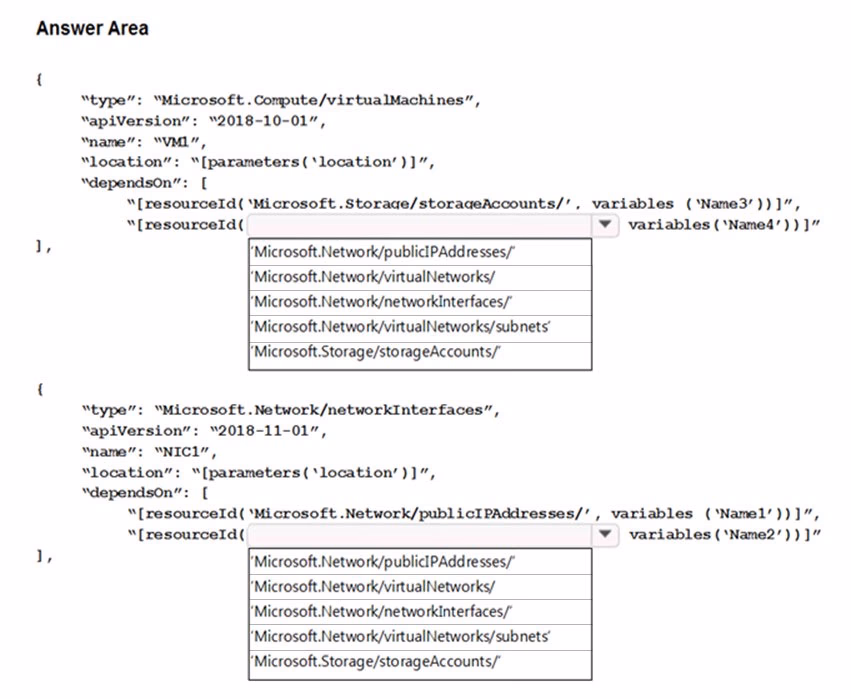

You play to deploy an Azure virtual machine named VM1 by using an Azure Resource Manager template.
You need to complete the template.
What should you include in the template? To answer, select the appropriate options in the answer area.
Exam AZ-303 Question 249
Within your template, the dependsOn element enables you to define one resource as a dependent on one or more resources. Its value can be a comma- separated list of resource names.
Box 1: 'Microsoft.Network/networkInterfaces'
This resource is a virtual machine. It depends on two other resources:
Microsoft.Storage/storageAccounts
Box 2: 'Microsoft.Network/virtualNetworks/'
The dependsOn element enables you to define one resource as a dependent on one or more resources. The resource depends on two other resources:
Microsoft.Network/publicIPAddresses

Not Correct. VM depends on NI, Storage, NI should depends on Subnet and Public IP.

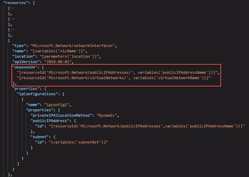

Given Answer is correct, to understand the dependency refers to the diagram. https://docs.microsoft.com/en-us/azure/azure-resource-manager/templates/media/template-tutorial-create-templates-with-dependent-resources/resource-manager-template-dependent-resources-diagram.png
jank
Feb 28, 2021
Given answer is correct. See steps 6 and 7 here: https://docs.microsoft.com/en-us/azure/azure-resource-manager/templates/template-tutorial-create-templates-with-dependent-resources?tabs=CLI#explore-the-template

Check the next question: It needs both subnet and vnet. The second choice does not look correct to me.

I suspect it is because there are other objects below /virtualNetworks/ that the NIC is dependant on - aside form Subnets. According to MS templates the given answer is correct

Correct answer. Its network interfaces and Virtual network Correct Answer. Its network intera https://docs.microsoft.com/en-us/azure/virtual-machines/windows/ps-template

What about the default subnet? with it, you wouldn't need to specify one

For the NIC either the vnet or subnet are possible answers but the subnet makes more sense. The resourceid function can accept multiple segments in the resource type https://docs.microsoft.com/en-us/azure/azure-resource-manager/templates/template-functions-resource#resourceid
