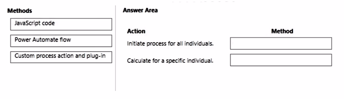

You need to implement scoring.
Which methods should you use? To answer, drag the appropriate methods to the correct actions. Each method may be used once, more than once, or not at all. You may need to drag the split bar between panes or scroll to view content.

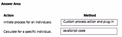

1: I would say power automate The automated process must run weekly to assess all candidates. 2: custom action + plugin the want to trigger from a command button

with that logic They could both be Power Automate couldnt they? Run the second one with a manual trigger?
itmaxuser
Apr 15, 2025
Action: Initiate process for all individuals ✅ Correct method: Power Automate flow This is a scheduled process (runs weekly). Power Automate can run on a schedule and loop through all Contact records to initiate scoring. Action: Calculate for a specific individual ✅ Correct method: Custom process action and plug-in The scoring logic needs to be centralized and reusable. A custom process action (triggered via JavaScript or command button) can invoke a plug-in to apply scoring logic for just one contact. The plug-in ensures calculations, updates, and any side effects (like email notifications) are handled in one place.
