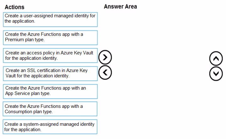

You are developing a serverless Java application on Azure. You create a new Azure Key Vault to work with secrets from a new Azure Functions application.
The application must meet the following requirements:
✑ Reference the Azure Key Vault without requiring any changes to the Java code.
✑ Dynamically add and remove instances of the Azure Functions host based on the number of incoming application events.
✑ Ensure that instances are perpetually warm to avoid any cold starts.
✑ Connect to a VNet.
✑ Authentication to the Azure Key Vault instance must be removed if the Azure Function application is deleted.
You need to grant the Azure Functions application access to the Azure Key Vault.

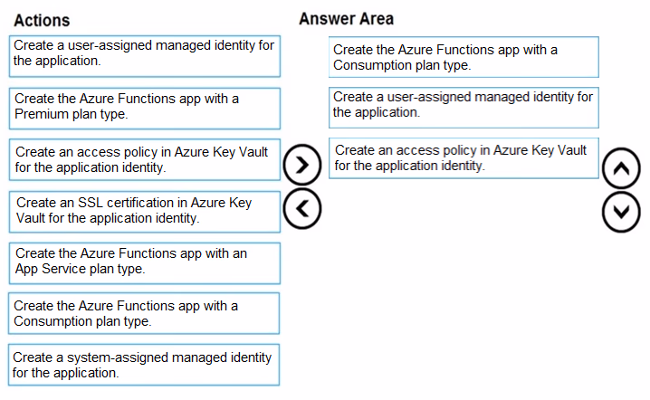

Step 1: Create the Azure Functions app with a Consumption plan type.
Use the Consumption plan for serverless.
Step 2: Create a system-assigned managed identity for the application.
Create a system-assigned managed identity for your application.
Key Vault references currently only support system-assigned managed identities. User-assigned identities cannot be used.
Step 3: Create an access policy in Key Vault for the application identity.
Create an access policy in Key Vault for the application identity you created earlier. Enable the "Get" secret permission on this policy. Do not configure the
"authorized application" or applicationId settings, as this is not compatible with a managed identity.
https://docs.microsoft.com/en-us/azure/app-service/app-service-key-vault-references

1. create ~Premium plan Type (Consumption X) 2. create system-assigned ~ (user-assigned X) 3. create an access policy in Azure Key Vault~

I agree with you. 1. Premium plan (avoid any cold starts and connect to a VNet) Overview of plans here: https://docs.microsoft.com/th-th/azure/azure-functions/functions-scale 2. create system-assigned => "A system-assigned identity is tied to your application and is deleted if your app is deleted." 3. create an access policy https://docs.microsoft.com/en-us/azure/app-service/app-service-key-vault-references?toc=%2Fazure%2Fazure-functions%2Ftoc.json&tabs=azure-cli

AGREE, HERE THE KEY IS: - It can be premium or appservice, as it says "add and remove instances of the Azure Functions host" is premium - System assigned because it says “Authentication to the Azure Key Vault instance must be removed if the Azure Function application is deleted” - Use an access policy to allow the identity of the system

Received this in my exam today (22/02/2023). Selected 'Created the Azure Function app with Premium plan type', 'Create a system-assigned managed identity for the application', and 'Create an access policy in Azure Key Vault for the application identity'. Score 927.
Samuel316
Apr 9, 2024
Answer shown in the image does not agree with what's written in the answer description. Image says user-assigned managed identity. Description says system-assigned managed identity, which would be more correct

1. Premium plan (avoid cold start) 2. system-assigned managed identity (we only have 1 Azure resource that our webapp needs to access and also the managed identity has to be removed when we delete or app.) 3. Create an access policy in Azure Key Vault.

1. Premium plan for function app (needs to connect to vnet) 2. System assigned managed identity (needs to be deleted when app is deleted and you need to do this from settings menu in the app service menu - need to create function app first) 3. Access policy - key vault.

The image with the correct answer and the solution text differs. The second step in the image states ‘Create a user assigned managed identity for the application’ while the solution text says, ‘Create a system-assigned managed identity for your application.’ with the annotation ‘Key Vault references currently only support system-assigned managed identities. User-assigned identities cannot be used.’ Further the provided link states that a user assigned managed identity as well as a system-assigned managed identities can be configured. I am not quite sure which of the answers are correct. Any ideas which one meets the given criteria?
