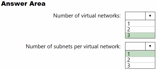

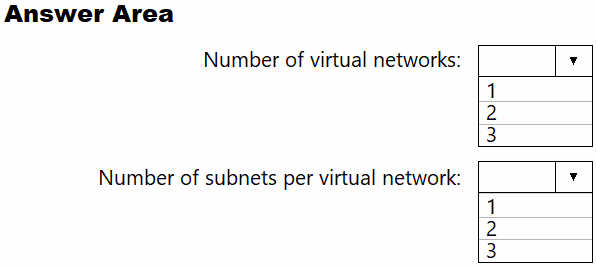

You need to recommend a solution for App1. The solution must meet the technical requirements.
What should you include in the recommendation? To answer, select the appropriate options in the answer area.
Exam AZ-303 Question 324
Box 1: 3 -
One virtual network for every tier
Box 2: 1 -
Only one subnet for each tier, to minimize the number of open ports.
Scenario: You have a public-facing application named App1. App1 is comprised of the following three tiers:
✑ A SQL database
✑ A web front end
✑ A processing middle tier
Each tier is comprised of five virtual machines. Users access the web front end by using HTTPS only.
Technical requirements:
✑ Move all the virtual machines for App1 to Azure.
Minimize the number of open ports between the App1 tiers.

TJ01
Jul 5, 2021
Should be 1 Vnet and 3 Subnets. See https://docs.microsoft.com/en-us/azure/architecture/reference-architectures/n-tier/n-tier-sql-server
rdemontis
Jul 19, 2021
Agree with you, thanks for posting the document
pentium75
Aug 4, 2021
Not sure because we're supposed to minimize the open ports between tiers. This is easier with 3 VNets than with 3 subnets in a single VNet.
mingled
Aug 5, 2021
Don't agree... You would need VNet peering + NSG's With 1 VNET and 3 Subnets, you simply control ports with Subnet Bound NSG's Creating 3 VNets would be overkill
AD3
Feb 19, 2022
3 VNETS : Costly, difficult to manage, difficult to operate, difficult to monitor. (difficult/complex). save cost and get bonus.
AD3
Feb 19, 2022
mingled
Aug 5, 2021
AD3
Feb 19, 2022
israelbarros
Aug 23, 2021
I agree
AD3
Feb 19, 2022
Aug 28, 2021
3 virtual networks and one subnet per virtual network - Creating a virtual network for each application tier is not a best practice. 3 virtual networks and three subnets per virtual network - This solution will have 9 subnets, that is more than the number of servers for App1. 1 virtual network and one subnet per virtual network - This solution will have all servers deployed in the same subnet, that is not a best practice. Answer is 1 Vnet with 3 subnets
Allahham
Jul 5, 2021
1 Vnet 3 Subnet
Tripp_F
Jul 7, 2021
Answer is incorrect. It should be: 1 Vnet, 3 subnets.
tita_tovenaar
Jul 25, 2021
I think 4 subnets, since we will need a GatewaySubnet too.
tita_tovenaar
Jul 25, 2021
... yes, I'm aware that's not even an option here LOL.
Spooky7
Nov 8, 2021
But which requirement is suggesting to use VPN?
donathon
Nov 23, 2021
1 VNet and 3 subnets. If we use 3 Vnet that would require higher admin effort. Also because of VNet peering, each Vnet will need to have 2 subnet include gateway subnet each.
edmacoar123
Nov 19, 2021
Today 19/11/21. No use case of this help platform appeared in my exam. Score 860.
news101
Jan 21, 2022
Answer is correct from security. If we have one VNET everything will be talking to each other with the default VirtualNetwork Tag. WIth three VNETs you would have to specify the NSG rules, which would block off traffic when you create the peer.
