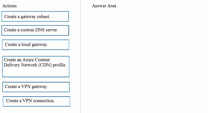

You have an on-premises network that you plan to connect to Azure by using a site-to-site VPN.
In Azure, you have an Azure virtual network named VNet1 that uses an address space of 10.0.0.0/16. VNet1 contains a subnet named Subnet1 that uses an address space of 10.0.0.0/24.
You need to create a site-to-site VPN to Azure.
NOTE: More than one order of answer choices is correct. You will receive credit for any of the correct orders you select.

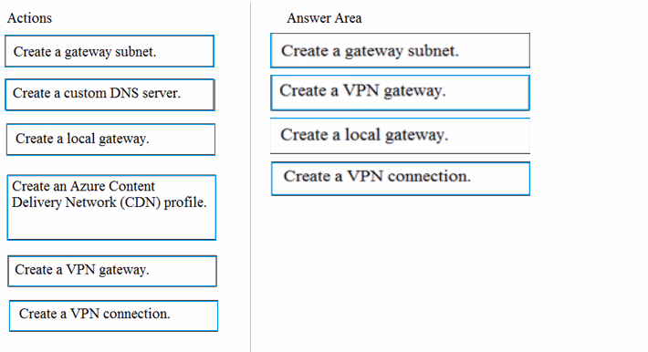

Correct Answer: As per documentation: 1. Create a virtual network 2. Create a VPN gateway 3. Create a local network gateway 4. Create a VPN connection 5. Verify the connection 6. Connect to a virtual machine Reference: https://docs.microsoft.com/en-us/azure/vpn-gateway/tutorial-site-to-site-portal https://docs.microsoft.com/en-us/azure/vpn-gateway/vpn-gateway-about-vpn-gateway-settings https://docs.microsoft.com/en-us/azure/vpn-gateway/vpn-gateway-howto-site-to-site-classic-portal
Aug 30, 2021
https://docs.microsoft.com/en-us/azure/vpn-gateway/vpn-gateway-about-vpn-gateway-settings Before you create a VPN gateway, you must create a gateway subnet Answer provided is correct
Spooky7
Nov 8, 2021
Is it possible to create local gateway before VPN gateway?
kmkr
Dec 7, 2021
I think this is what they meant by "More than one order of answer choices is correct". In my opinion it may be alternate
