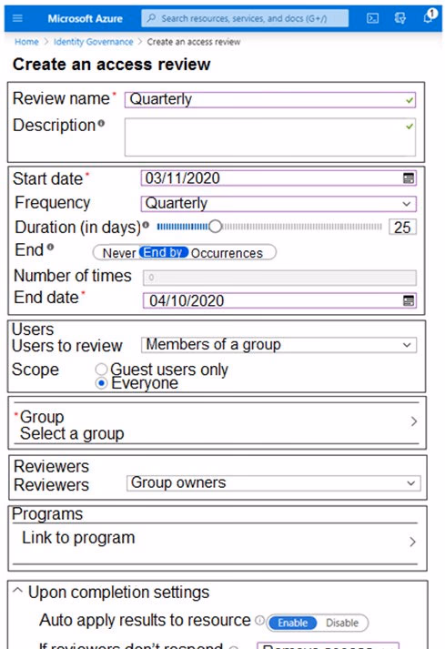

You plan to implement an access review to meet the following requirements:
✑ The access review must be enforced until otherwise configured.
✑ Each user or group that has access to the Azure environment must be in the scope of the access review.
✑ The access review must be completed within two weeks.
✑ A lack of response must not cause changes in the operational environment.
An administrator creates the access review shown in the answer area.
Which two sections of the access review should you modify to meet the requirements? To answer, select the appropriate sections in the answer area.
Exam AZ-303 Question 84

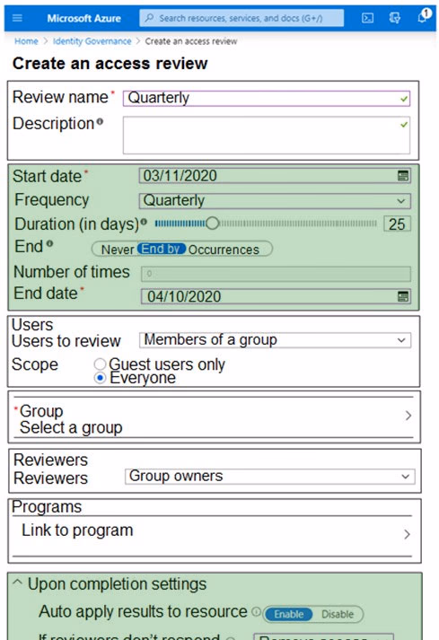

Area 1: Start date..End Date -
The access review must be enforced until otherwise configured. We set End: Never
The access review must be completed within two weeks. We set Duration (in days) to 14
Area 2: Upon completion settings
A lack of response must not cause changes in the operational environment. We set 'If reviewers don't respond: No change (which leave user's access unchanged)
https://docs.microsoft.com/en-us/azure/active-directory/governance/create-access-review

Image is cropped. The correct answer is at https://www.microsoftbraindumps.com/12-nov-2020-update-exam-az-303-vce-dumps-and-az-303-pdf-dumps-from-passleader.html xplanation: Area 1: The access review must be enforced until otherwise configured. We set End: Never. The access review must be completed within two weeks. We set Duration (in days) to 14. Area 2: A lack of response must not cause changes in the operational environment. We set If reviewers don’t respond: No change (which leave user’s access unchanged).

Jan 10, 2021
Image is cropped, so it's unclear what is configured in 'Upon completion settings' section
nexnexnex
Jan 10, 2021
And there is a requirement 'Each user or group that has access to Azure must be assessed', while on the screenshot configured 'only specific groups' without anything selected
pkpp
Jan 16, 2021
Users section has a "Everyone" radio button selected and it's not a specific group. "Members of a group" with "everyone" satisfies "Each user or group that has access to Azure must be assessed'. Last section is cutoff so hard to know whether that is the answer.
pkpp
Jan 16, 2021

Nov 26, 2021
Answer: START DATE & UPON COMPLETION SETTINGS
