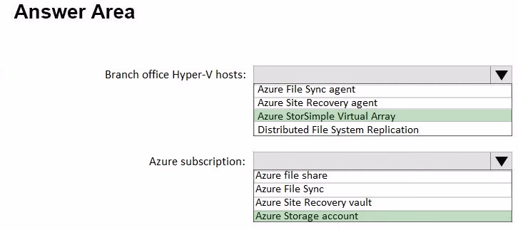

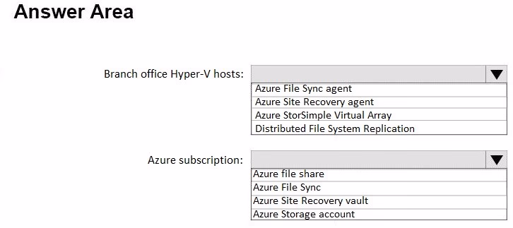

Your company has three branch offices and an Azure subscription. Each branch office contains a Hyper-V host that hosts application servers.
You need to recommend a storage solution for the branch offices. The solution must ensure that the application servers can connect to a central storage device by using iSCSI connections. Data saved to the iSCSI storage device from the application servers must be uploaded to Azure automatically.
Which components should you include in the recommendation? To answer, select the appropriate options in the answer area.

This question may be old but the provided answer is correct , cuz of the "ISCSI"

Given answer is correct. Focus on iSCSI The Microsoft Azure StorSimple Virtual Array is an integrated storage solution that manages storage tasks between an on-premises virtual array running in a hypervisor and Microsoft Azure cloud storage. The virtual array is an efficient, cost-effective, and easily managed file server or iSCSI server solution that eliminates many of the issues and expenses associated with enterprise storage and data protection. The virtual array is particularly well-suited for the storage of infrequently accessed archival data.

AFS cannot act as an iSCSI target for other servers, it can be hosted on a server that is configured with and iSCSI initiator that connects to a storage array with one or more iSCSI Targets configured. The storesimple is iSCSI only and can be a target for multiple initiators (clients) meeting the requirement listed. regardless of the intention to retire the storesimple, this is the correct answer to this question

Justification to answer Given the choice, StorSimple support iSCSI and storage account need to have in place.
