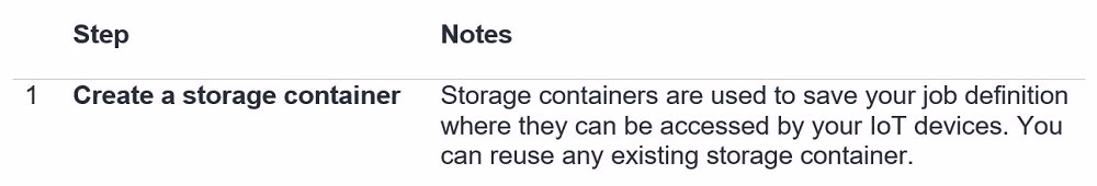

You need to have a storage container for the job definition:
Installation instructions -
The high-level steps are described in the following table. More details are given in the following sections.
