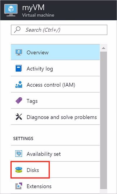

Step 3: On the Virtual machine page, , in Essentials, select Disks.

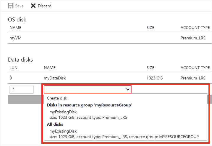

Step 4: On the Disks page, select the Web01-Disk1 from the list of existing disks.
Step 5: In the Disks pane, click + Add data disk.
Step 6: Click the drop-down menu for Name to view a list of existing managed disks accessible to your Azure subscription. Select the managed disk Web01-Disk1 to attach:
