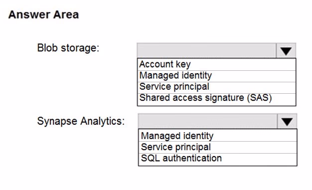

You are designing an Azure data factory that will copy data from Azure Blob storage to a data warehouse in Azure Synapse Analytics.
You need to recommend an authentication mechanism that meet the following requirements:
✑ Identities must be validated by using Azure Active Directory (Azure AD).
✑ Development and maintenance effort must be minimized.
Which authentication mechanism should you recommend for each service? To answer, select the appropriate options in the answer area.

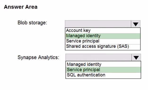

Both boxes should be Managed Identity: https://docs.microsoft.com/en-us/azure/synapse-analytics/security/synapse-workspace-managed-identity
Wendy_DK
May 29, 2021
After carefully read the reference and the requirement(Development and maintenance effort must be minimized) in the question. Both boxes should be Managed Identity. Here is the reason: By using Managed Identity, it takes two steps By using service principal, it needs three steps Ref. https://docs.microsoft.com/en-us/azure/data-factory/connector-azure-sql-data-warehouse
Wendy_DK
May 21, 2021
Azure data factory can use Managed Identity and service principal both as authentication. question here is :You are designing an Azure data factory that will copy data from Azure Blob storage to a data warehouse in Azure Synapse Analytics. Answer here is correct. If some one pick up Managed Identity on the second box, it should be correct answer too
massnonn
Nov 18, 2021
both Managed indentity, the moc describe that blob storage supported managed identity
