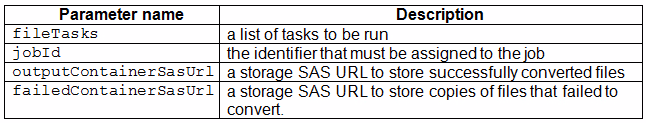

You have an Azure Batch project that processes and converts files and stores the files in Azure storage. You are developing a function to start the batch job.
You add the following parameters to the function.
Exam AZ-203 Question 1
You must ensure that converted files are placed in the container referenced by the outputContainerSasUrl parameter. Files which fail to convert are placed in the container referenced by the failedContainerSasUrl parameter.
You need to ensure the files are correctly processed.
How should you complete the code segment? To answer, select the appropriate options in the answer area.
To ensure that converted files are placed in the container referenced by the outputContainerSasUrl parameter and files which fail to convert are placed in the container referenced by the failedContainerSasUrl parameter, you should complete the code segment as follows: 1. Use CreateJob to create the batch job. This function initializes the job, adds necessary metadata, and prepares it for task execution. 2. For handling successfully converted files, use the TaskSuccess event. This ensures that files are uploaded only after the task process exits with a zero exit code, indicating success. 3. For handling failed conversions, use the TaskFailure event. This ensures that files are uploaded only when the task process exits with a non-zero exit code, indicating failure. 4. Utilize OutputFiles to specify the output files for each task. Create a collection of OutputFile objects and assign it to the CloudTask.OutputFiles property when creating the task. This correctly routes the files to their respective containers based on the success or failure of each task.
