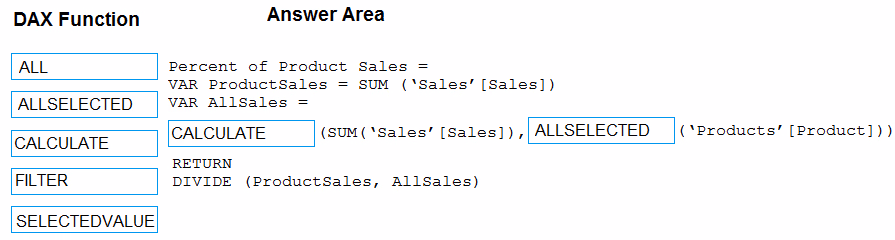

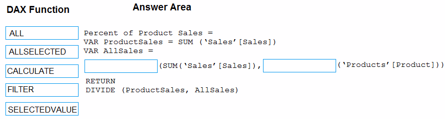

You have a Power BI data model that contains two tables named Products and Sales.
A one-to-many relationship exists between the tables.
You have a report that contains a report-level filter for Products.
You need to create a measure that will return the percent of total sales for each product. The measure must respect the report-level filter when calculating the total.
How should you complete the DAX measure? To answer, drag the appropriate DAX functions to the correct targets. Each function may be used once, more than once, or not at all. You may need to drag the split bar between panes or scroll to view content.
Exam PL-300 Question 103

Incorrect answer. 1.Calculate 2. ALLSELECTED. ALLSELECTED Removes only the filter on the expression visual but respect all external filters.

ALLSELECTED is correct. ALLSELECTED: Returns all the rows in a table, or all the values in a column, ignoring any filters that may have been applied inside the query, but keeping filters that come from the outside. https://mitchellpearson.com/2020/09/14/understanding-row-context-in-dax-and-power-bi/#:~:text=ALLSELECTED%20DAX%20functions,coming%20from%20the%20inner%20query.

Correct. This function (ALLSELECTED) is different from ALL() because it retains all filters explicitly set within the query, and it retains all context filters other than row and column filters.

I think you are wrong, the answer should be "ALLSelected" instead of "ALL". Lets think about the difference here: "ALLSelected" takes consider of external filter (here we have a report-level filter as we are filtering products to check their sales percentage), while "ALL" ingnores all filters. I also tested out a toy dataset in Power BI. Say I have four products, each makes up 25% of total sales. If we use "ALL" DAX and choose product A&B in the filter, we will see A and B both make up 25% of total sales, but instead what we want is "ALLSELECT" DAX which gives us A and B both makes up 50% of total sales, this meets the question requirement of "respect the report-level filter".
Kai_don
Jan 10, 2023
Answer is wrong. Second box should be allselected

Definitely CALCULATE and ALLSELECTED Using ALLSELECTED respects the filter defined on the page.

CALCULATE and ALLSELECTED Tested

Correct answer. CALCULATE & ALLSELECTED. Tested and works Product Sale% = VAR ProductSales = SUM('Sales'[Sales]) VAR AllSales = CALCULATE(SUM('Sales'[Sales]),ALLSELECTED('Product'[Product Name])) Return DIVIDE(ProductSales,AllSales)
