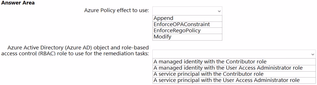

You need to design an Azure policy that will implement the following functionality:
✑ For new resources, assign tags and values that match the tags and values of the resource group to which the resources are deployed.
✑ For existing resources, identify whether the tags and values match the tags and values of the resource group that contains the resources.
✑ For any non-compliant resources, trigger auto-generated remediation tasks to create missing tags and values.
The solution must use the principle of least privilege.
What should you include in the design? To answer, select the appropriate options in the answer area.
Exam AZ-305 Question 20

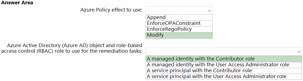

Box 1: Modify -
Modify is used to add, update, or remove properties or tags on a subscription or resource during creation or update. A common example is updating tags on resources such as costCenter. Existing non-compliant resources can be remediated with a remediation task. A single Modify rule can have any number of operations. Policy assignments with effect set as Modify require a managed identity to do remediation.
Incorrect:
* The following effects are deprecated: EnforceOPAConstraint EnforceRegoPolicy
* Append is used to add additional fields to the requested resource during creation or update. A common example is specifying allowed IPs for a storage resource.
Append is intended for use with non-tag properties. While Append can add tags to a resource during a create or update request, it's recommended to use the
Modify effect for tags instead.
Box 2: A managed identity with the Contributor role
The managed identity needs to be granted the appropriate roles required for remediating resources to grant the managed identity.
Contributor - Can create and manage all types of Azure resources but can't grant access to others.
Incorrect:
User Access Administrator: lets you manage user access to Azure resources.
https://docs.microsoft.com/en-us/azure/governance/policy/concepts/effects https://docs.microsoft.com/en-us/azure/governance/policy/how-to/remediate-resources https://docs.microsoft.com/en-us/azure/role-based-access-control/built-in-roles

1. Modify 2. Managed identity with Contributor role https://learn.microsoft.com/en-us/azure/governance/policy/concepts/effects#modify Modify is used to add, update, or remove properties or tags on a subscription or resource during creation or update. A common example is updating tags on resources such as costCenter. Existing non-compliant resources can be remediated with a remediation task. A single Modify rule can have any number of operations. Policy assignments with effect set as Modify require a managed identity to do remediation.
zellck
Feb 26, 2023
https://learn.microsoft.com/en-us/azure/governance/policy/how-to/remediate-resources?tabs=azure-portal#how-remediation-access-control-works When Azure Policy starts a template deployment when evaluating deployIfNotExists policies or modifies a resource when evaluating modify policies, it does so using a managed identity that is associated with the policy assignment. Policy assignments use managed identities for Azure resource authorization. You can use either a system-assigned managed identity that is created by the policy service or a user-assigned identity provided by the user. The managed identity needs to be assigned the minimum role-based access control (RBAC) role(s) required to remediate resources. If the managed identity is missing roles, an error is displayed in the portal during the assignment of the policy or an initiative.

Based only on the new wording of the question you indicate, I think the correct answers are: 1- Modify 2- RBAC of the remediation task Microsoft says: "As a prerequisite, the policy definition must define the roles that deployIfNotExists and modify need to successfully deploy the content of the included template. " https://learn.microsoft.com/en-us/azure/governance/policy/how-to/remediate-resources?tabs=azure-portal#configure-the-policy-definition The managed identiy used is not included in the template

Modify and managed identity with contributor role. The following effects are deprecated: EnforceOPAConstraint EnforceRegoPolicy https://docs.microsoft.com/en-us/azure/governance/policy/concepts/effects https://docs.microsoft.com/en-us/azure/governance/policy/how-to/remediate-resources?tabs=azure-portal https://docs.microsoft.com/en-us/azure/role-based-access-control/built-in-roles

RIGHT answer for Artificial Int.: Azure Policy Effect to Use: Modify: Use the "Modify" effect to ensure that new resources inherit the tags and values from their respective resource groups, allows you to add or change properties of resources during their creation, ensuring they comply with your tagging policy. not others: - Append: Useful for adding tags, but it doesn't allow for changes if the tags already exist. - EnforceOPAConstraint and EnforceRegoPolicy: Are used in kubernetes Scenario. Azure Active Directory (Azure AD) Object and Role-Based Access Control (RBAC) Role to Use for the Remediation Tasks: -A managed identity with the Contributor role: The Contributor role has the necessary permissions to modify existing resources and apply tags, aligning with the principle of least privilege. Managed identities are ideal for this task because they provide a secure way to grant access without requiring explicit credentials.
MeisAdriano
Oct 21, 2024
Not others: - Managed identity with the User Access Administrator role: This role is not required for tagging; it's primarily for managing user access. - Service principal with the Contributor role: While this would work, managed identities are generally preferred for automation and security. - Service principal with the User Access Administrator role: Same as above, unnecessary for tagging tasks.

Box 1:Modify Box 2: A managed identity with the Contributor role Correct ans

given answer is correct. Modify:The Modify effect can enforce changes to existing resources to make them compliant with the policy, including adding or updating tags. It can also handle new resources and ensure they comply with the required tags, fulfilling all the specified requirements. A managed identity with the Contributor role is the best choice for the RBAC role, as it provides the necessary permissions to perform the required tasks while adhering to the principle of least privilege
