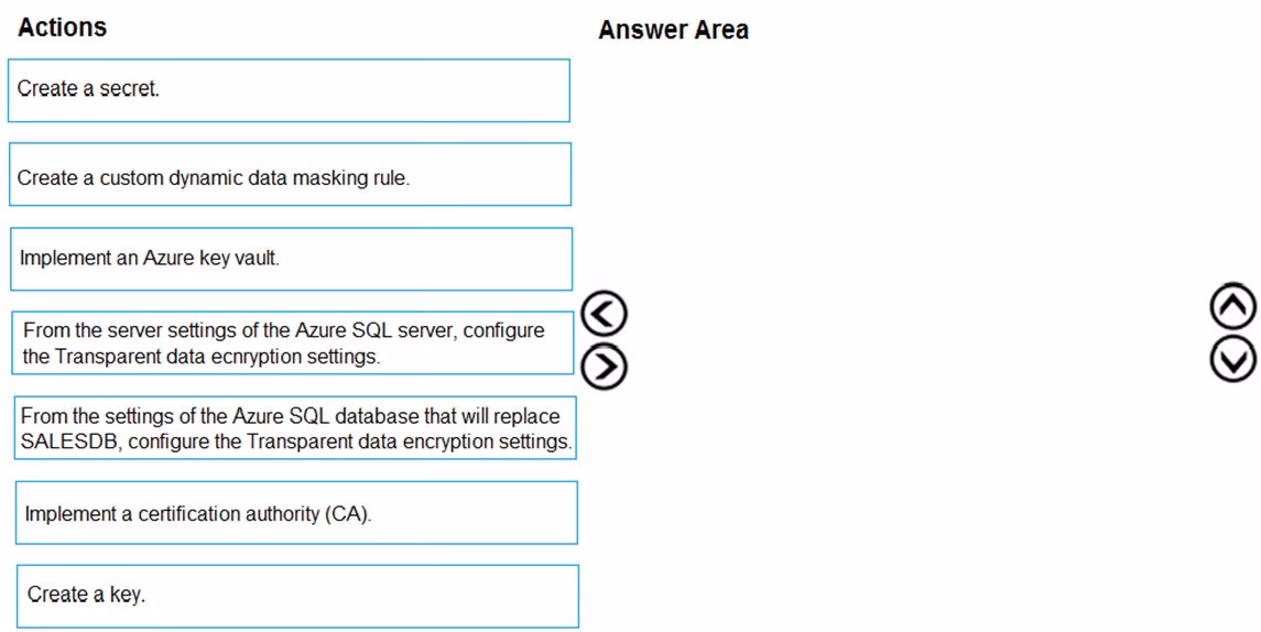

DP-200 Exam - Question 205
You need to implement the encryption for SALESDB.
Exam DP-200 Question 205

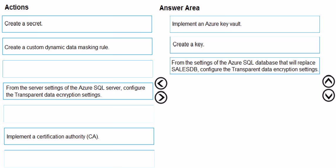

Data in SALESDB must encrypted by using Transparent Data Encryption (TDE). The encryption must use your own key.
Step 1: Implement an Azure key vault
You must create an Azure Key Vault and Key to use for TDE
Step 2: Create a key -
Step 3: From the settings of the Azure SQL database ג€¦
You turn transparent data encryption on and off on the database level.
https://docs.microsoft.com/en-us/azure/sql-database/transparent-data-encryption-byok-azure-sql-configure
Alekx42
May 29, 2021
To enable TDE with your own key you must do it at the Azure SQL SERVER level. At the Azure SQL DATABASE you can only turn it on / off. Since one of the requirement is that you must use your own key, the correct answer is the following: 1 - Create key vault 2 - Create a key 3 - From the setting of the Azure SQL server, configure TDE (by selecting the newly created key) However, it is also possible to create a key (or even the Azure key vault!) directy while enabling TDE from Azure SQL Server. So I guess you could shuffle the above steps and say that 1 - 3 - 2 is the correct answer... or even 3 - 1 - 2... personally I think that 1 - 2 - 3 just makes more sense.
Mily94
Apr 29, 2021
second shouldn't be A - secret?
Szym0ngl
May 13, 2021
Should be: Step 3: From the settings of the Azure SQL server, configure the Transparent data encryption settings (https://www.sqlshack.com/transparent-data-encryption-tde-on-the-azure-sql-database/,https://docs.microsoft.com/en-us/azure/azure-sql/database/transparent-data-encryption-byok-configure?tabs=azure-powershell)
Srinivasnaveen
May 22, 2021
Should be Step 2: From the settings of the Azure SQL server, configure the Transparent data encryption settings Step 3 : Create a Key (https://www.sqlshack.com/transparent-data-encryption-tde-on-the-azure-sql-database/)
dumpi
Jun 13, 2021
given answer is correct
wxlf23
Sep 15, 2021
1 - Create key vault 2 - Create a SECRET 3 - From the setting of the Azure SQL SERVER, configure TDE settings https://github.com/MicrosoftLearning/DP-203-Data-Engineer/blob/master/Instructions/Labs/LAB_08_security_with_synapse_analytics.md
