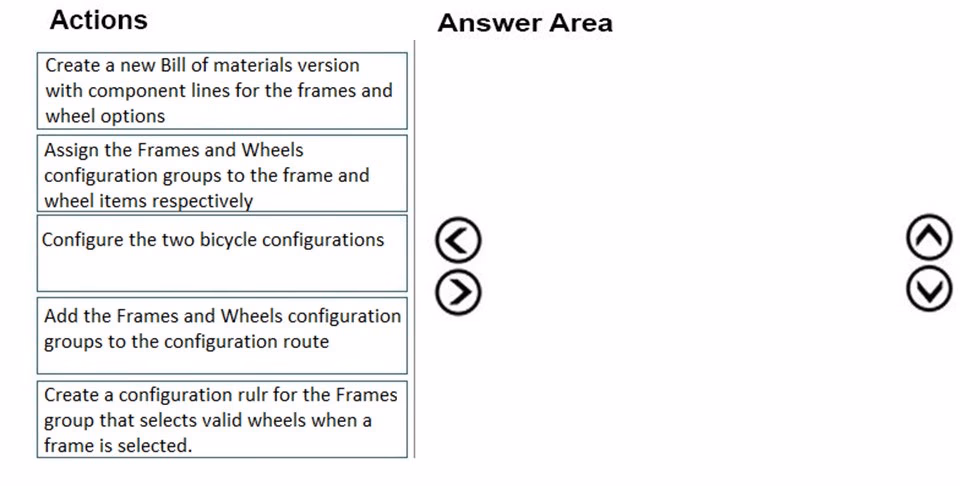

A company produces custom-made bicycles that offer many different configurations.
Your standard bicycle, B-0001, is made with many common components such as a frame and wheels. Customers can choose between two frames: F-0001 or F-
0009. Wheel W-0001 is only compatible with frame F-0001.
You create the following configuration groups: Frames, Wheels.
You need to ensure that users can only select valid combinations of frames and wheels.
In which order should you perform the actions? To answer, move all actions from the list of actions to the answer area and arrange them in the correct order.
Exam MB-320 Question 35

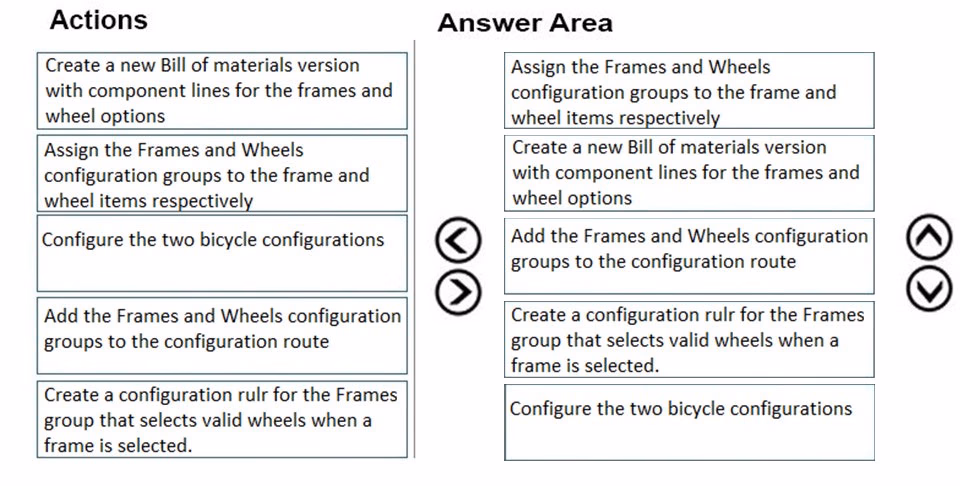

szysta
Jul 30, 2020
Shouldn't answer 1 be swapped with 2? The configuration groups are really assigned to the BOM lines - not the items as such, so the BOM has to come first.
ZVV
Feb 20, 2021
Agree, create bom and lines assign conf group to lines create conf route rules create configuration
Alexpet
Nov 1, 2021
The answer appears correct. In the instructions you assign config group to frame and wheel before completing the BOM and activating it. https://docs.microsoft.com/en-us/dynamics365/supply-chain/pim/tasks/create-bill-materials-dimension-based-product-master
