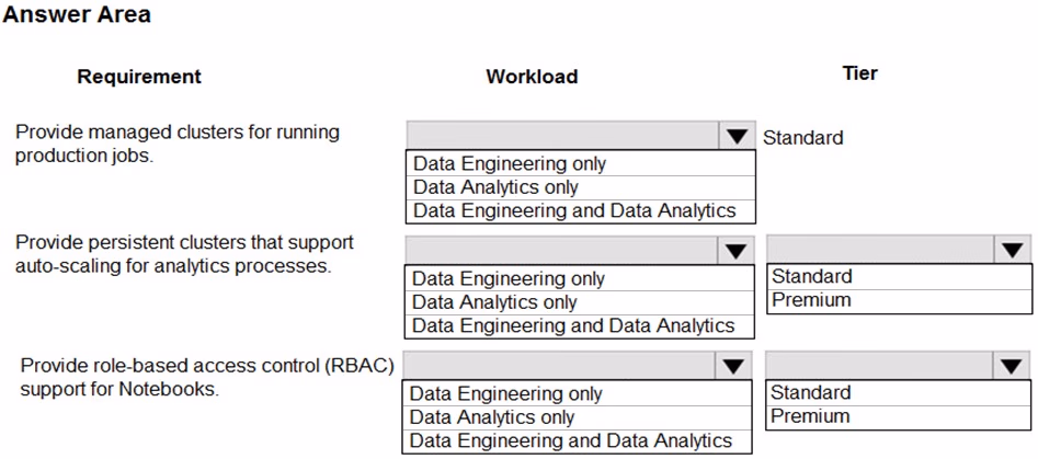

You are designing a solution for a company. You plan to use Azure Databricks.
You need to recommend workloads and tiers to meet the following requirements:
✑ Provide managed clusters for running production jobs.
✑ Provide persistent clusters that support auto-scaling for analytics processes.
✑ Provide role-based access control (RBAC) support for Notebooks.
What should you recommend? To answer, select the appropriate options in the answer area.
Exam DP-201 Question 92

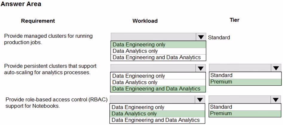

Box 1: Data Engineering Only -
Box 2: Data Engineering and Data Analytics
Box 3: Standard -
Box 4: Data Analytics only -
Box 5: Premium -
Premium required for RBAC. Data Analytics Premium Tier provide interactive workloads to analyze data collaboratively with notebooks
https://azure.microsoft.com/en-us/pricing/details/databricks/

Filippo
Apr 23, 2020
Based on MS documentation (https://azure.microsoft.com/en-us/pricing/details/databricks/) the answers should be: Box 1 = Data Engineering and Data Analytics, Box 2 = Data Analytics only, Box 3 = Standard, Box 4 = Data Engineering and Data Analytics, Box 5 = Premium

Since the ask is to run Production Jobs, why not for Box 1 ==> Data Engineering only? Data Analytics is for Data Scientists for interactive workloads...

both Data Analytics and Data Engineering are feasible for the requirement unless we are talking about cost reduction then 'Data Engineering' is the only appropriate answer

Best article I have found that explains this: https://sql-stack.com/2018/11/29/azure-databricks-workloads-and-job-scheduling/#:~:text=The%20Data%20Engineering%20workload%20is,the%20duration%20of%20the%20job.&text=This%20workload%20is%20also%20designed,the%20administrator%20in%20the%20workload. 1. Data engineering and standard (data engineering is meant for jobs, will tear itself down) 2. Data analytics and standard (is meant for ad-hoc analysis, will stay up) 3. Data engineer and analytics and premium (RBAC is a premium feature)

Box 1: Data Engineering (Jobs Compute) and Data Analytics (All-Purpose Compute) Box 2: Data Engineering (Jobs Compute) and Data Analytics (All-Purpose Compute) Box 3: Standard Box 4: Data Engineering (Jobs Compute) and Data Analytics (All-Purpose Compute) Box 5: Premium

https://azure.microsoft.com/en-us/pricing/details/databricks/ Reading this link, it looks like Data Analytics has been rebranded to "All purpose Compute", and Data Engineering to "Jobs Compute". In which case, the answers given by wak are correct.

Box 2 should be premium for - Optimized autoscaling of compute

Box 3 can be Standard. See the "Autopilot" option in the Standard plan on this link: https://databricks.com/product/azure-pricing

https://sql-stack.com/2018/11/29/azure-databricks-workloads-and-job-scheduling/ 1. Production Job (scheduled operations) - Data Engineering Only, Standard Tier 2. Persistent for analytics, auto-scaling - Data Analytics Only, Standard Tier 3. Role-based access - For both Data Engineering and Data Analytics, Premium Tier
