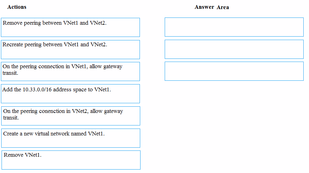

You have an Azure subscription that contains two virtual networks named VNet1 and VNet2. Virtual machines connect to the virtual networks.
The virtual networks have the address spaces and the subnets configured as shown in the following table.
Exam AZ-303 Question 223
You need to add the address space of 10.33.0.0/16 to VNet1. The solution must ensure that the hosts on VNet1 and VNet2 can communicate.

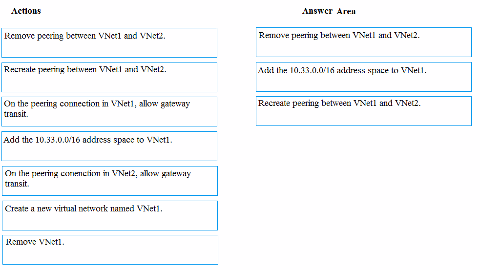

Step 1: Remove peering between Vnet1 and VNet2.
You can't add address ranges to, or delete address ranges from a virtual network's address space once a virtual network is peered with another virtual network.
To add or remove address ranges, delete the peering, add or remove the address ranges, then re-create the peering.
Step 2: Add the 10.44.0.0/16 address space to VNet1.
Step 3: Recreate peering between VNet1 and VNet2
https://docs.microsoft.com/en-us/azure/virtual-network/virtual-network-manage-peering
widurr
Jan 4, 2021
correct
scorpion20047
Jan 20, 2021
repeated question
Amit3
Jan 17, 2021
Answer is correct
R3dex
Aug 12, 2021
The question lacks the detail of them two VNETs having a peering :)
Rachanz
Nov 18, 2021
the table already mentioned that.
