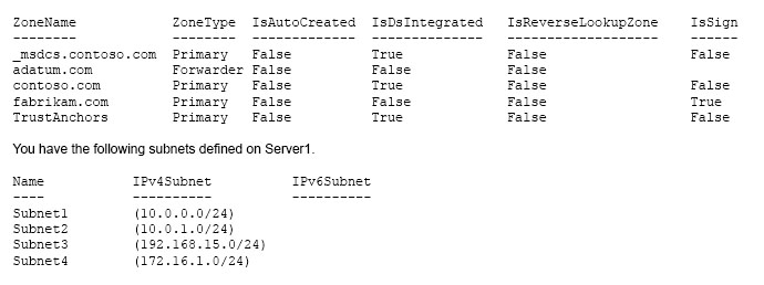

Your network contains an Active Directory domain named contoso.com. The domain contains a DNS server named Server1. All client computers run Windows 10.
On Server1, you have the following zone configuration:
You need to prevent Server1 from resolving queries from DNS clients located on Subnet4. Server1 must resolve queries from all other DNS clients.
Solution: From the Security setting of each zone on Server1, you modify the permissions.
Does this meet the goal?
Modifying the Security settings of each zone to change permissions is not the correct method to prevent Server1 from resolving queries from DNS clients located on Subnet4. DNS zone permissions control who can modify or manage the zones, but they do not control from which subnets the DNS server responds to queries. The correct approach is to configure the DNS server's response policies or use firewall rules to block DNS queries from Subnet4.

Is this meant to be in the 70-740 exam? Sounds like it belongs in 70-741?
davidtldOption: B
Dec 16, 2019
You need to update permissions to the Subnet. The zone permissions are not relevant
