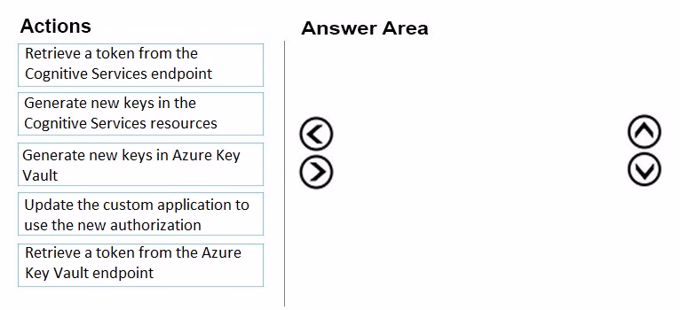

You develop a custom application that uses a token to connect to Azure Cognitive Services resources.
A new security policy requires that all access keys are changed every 30 days.
You need to recommend a solution to implement the security policy.
Which three actions should you recommend be performed every 30 days? To answer, move the appropriate actions from the list of actions to the answer area and arrange them in the correct order.
Exam AI-100 Question 155

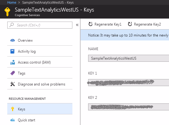

Step 1: Generate new keys in the Cognitive Service resources
Step 2: Retrieve a token from the Cognitive Services endpoint
Step 3: Update the custom application to use the new authorization
Each request to an Azure Cognitive Service must include an authentication header. This header passes along a subscription key or access token, which is used to validate your subscription for a service or group of services.
https://docs.microsoft.com/en-us/azure/cognitive-services/authentication

coz the question is about access keys which exist against the deployed cognitive service
