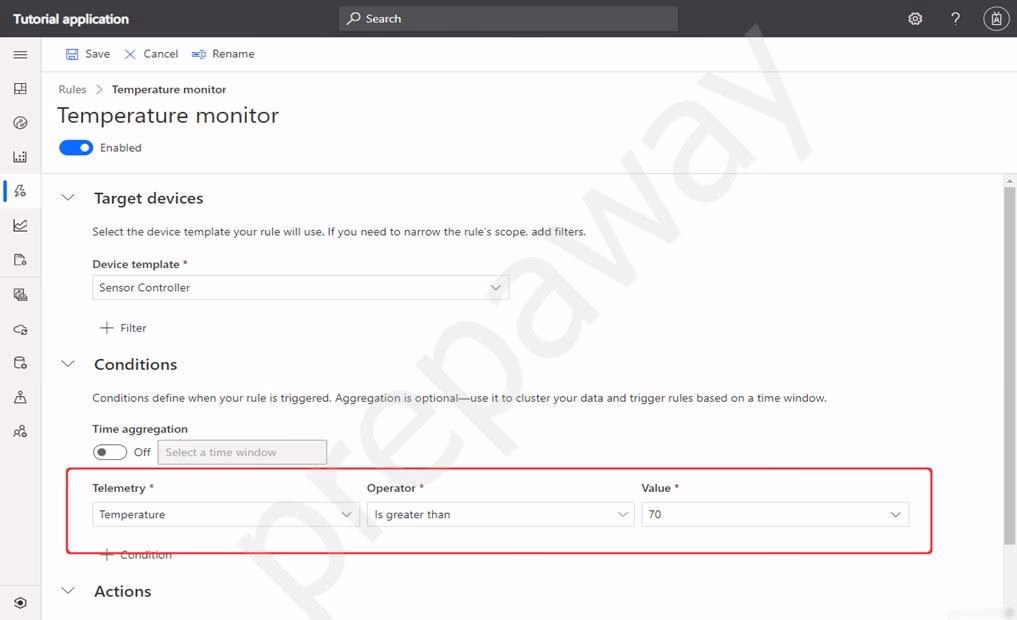

Devices use telemetry to send numerical data from the device. A rule triggers when the selected telemetry crosses a specified threshold.
E: To create a telemetry rule, the device template must include at least one telemetry value. The rule monitors the temperature reported by the device and sends an email when it falls below 400 degrees.
B: Configure the rule conditions.
Conditions define the criteria that the rule monitors. In this tutorial, you configure the rule to fire when the temperature exceeds 70ֲ° F.
1. Select Temperature in the Telemetry dropdown.
2. Next, choose Is less than as the Operator and enter 400 as the Value.
Exam AZ-220 Question 38
3. Optionally, you can set a Time aggregation. When you select a time aggregation, you must also select an aggregation type, such as average or sum from the aggregation drop-down.
✑ Without aggregation, the rule triggers for each telemetry data point that meets the condition.
✑ With aggregation, the rule triggers if the aggregate value of the telemetry data points in the time window meets the condition.
