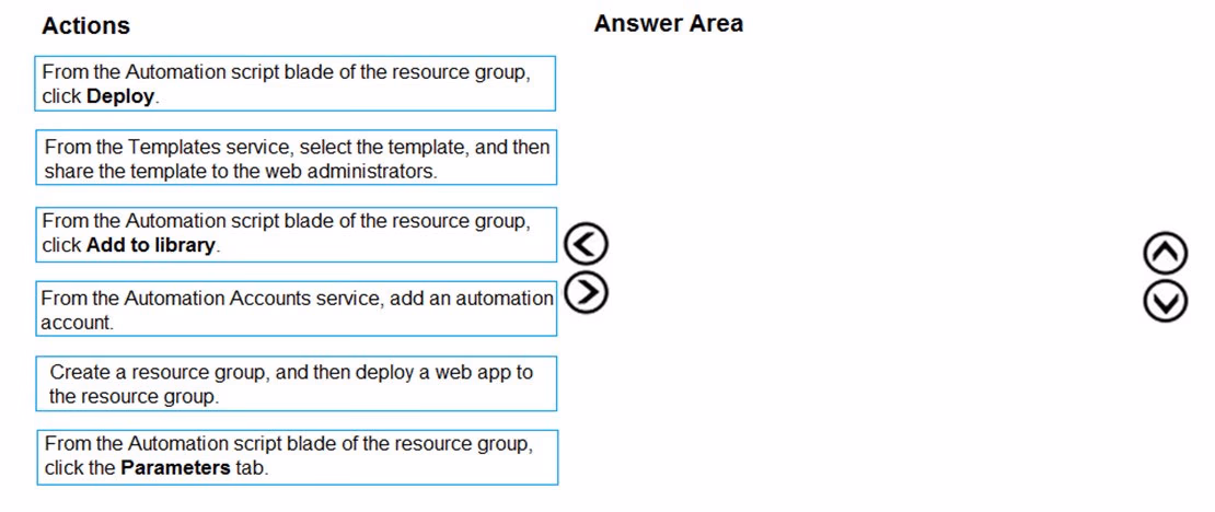

You need to prepare the environment to ensure that the web administrators can deploy the web apps as quickly as possible.

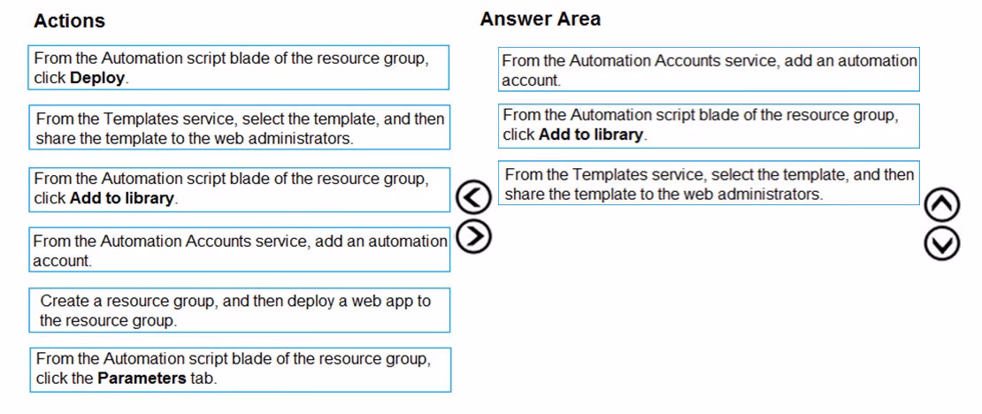

Step 1:
First you create a storage account using the Azure portal.
Step 2:
Select Automation options at the bottom of the screen. The portal shows the template on the Template tab.
Add the storage account to the library.
Step 3:
Share the template.
Scenario: Web administrators will deploy Azure web apps for the marketing department. Each web app will be added to a separate resource group. The initial configuration of the web apps will be identical. The web administrators have permission to deploy web apps to resource groups.

1) Create RG , and then deploy a web app to the RG 2) From the Automation script blade of the RG , click "Add to Library" 3) From the Templates service, select the template, and then share the template to the web admins
Sumbasa
Jan 5, 2021
Where my thoughts too.
xaccan
Jan 19, 2021
correct

was now moved to Automation -> Export -> Add to Library
Aug 31, 2021
Web administrators will deploy Azure web apps for the marketing department. Each web app will be added to a separate resource group. The initial configuration of the web apps will be identical. The web administrators have permission to deploy web apps to resource groups 1) Create RG , and then deploy a web app to the RG 2) From the Automation script blade of the RG , click "Add to Library" 3) From the Templates service, select the template, and then share the template to the web admins Try it for yourself in the portal; it works
